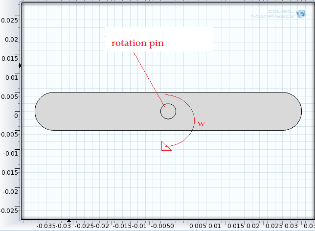

I would like to simulate the rotation of a beam in relation to the center pin (see figure).
So I ask:
(1) How to simulate the rotating with angular velocity (w)?
(2) What comsol simulation module is better to make this rotation?
Thanks a lot

if it is a rigid rotation in Solid, extract the pin domain (geometry difference) select the round boundary and use a rigid connector with user defined CoR 0,0,0 and constrained X,Y,Z position (of CoR 2nd tab) and that should do. but you are adding several equations to your system.
Another way is to add a global equation to constrain the average of the x and y position of your boundary to the CoR

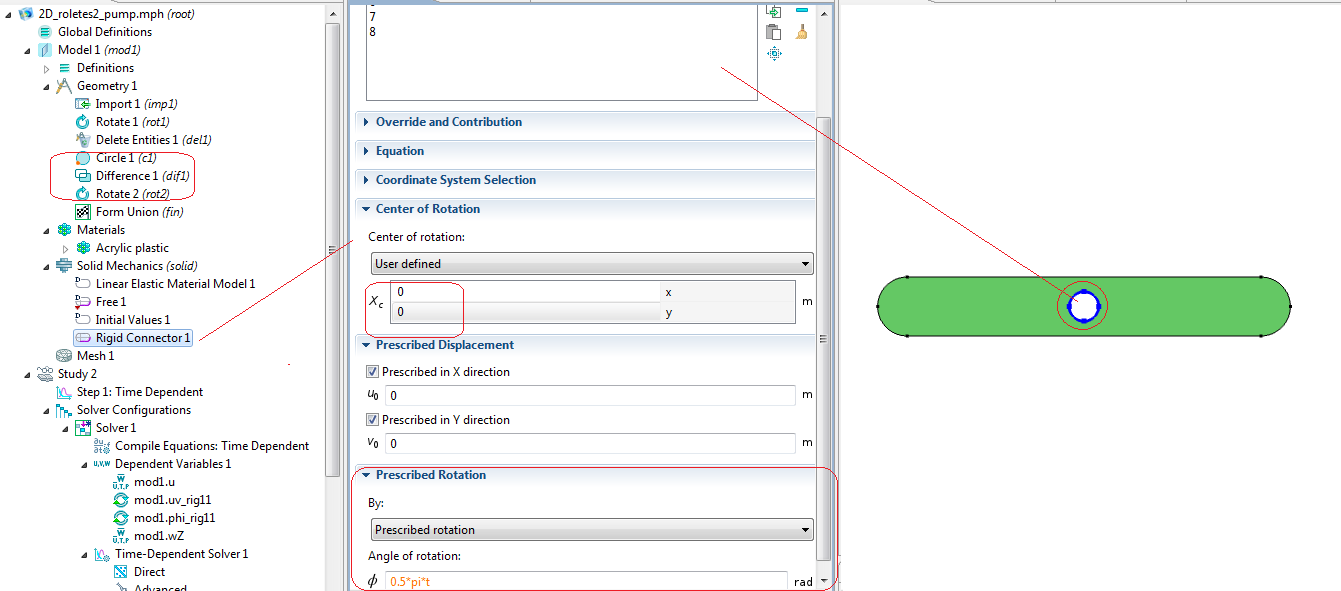

I extracted the geometry of pin (geometry difference) and selected the round boundary using rigid connecto.
My center of rotation is Xc = (0.0), and I would like to make a prescribed rotation (pi / 2) * t with time dependent = range (0,0.1,1), but my simulation did not converge.

are you in time dependent solver sequence ?
just to get consistent units write rather 2*pi*t[1/s] to clear the orange unit warning for the imposed rotation angle
for me it does converge, but I'm using arbitrary material values.

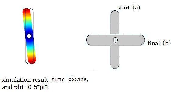

The simulation ran, but did not provide the expected result. I thought then to rotate a solid 90° it would be necessary (phi = 0.5 * pi * t [1 / s]) and time=0:0.1:1s. However the simulation results, presented a very small rotation (figure attached).
How do I rotate the solid at 90°?
I'm using rigid connector with comsol v4.2a.
thanks again!

You are fooled by the automatic scaling of COMSOL. The programmes is not set up for "large deformations like that, if you search in the plot node you will find deep under the scaling tab, go to manual scaling and set a value of 1, then it should work better.
Pls notice that I'm using the structural "small angle displacements" the 0.5*solid.curlUZ, this is based on linear theory so it's not really valid or angles above some 5-6° of rotation, be aware. I did neither not turn on "large displacements" that might be usefull of your solid part (not the rotation by itself) is defoming a lot.
Hi You are fooled by the automatic scaling of COMSOL. The programmes is not set up for "large deformations like that, if you search in the plot node you will find deep under the scaling tab, go to manual scaling and set a value of 1, then it should work better. Pls notice that I'm using the structural "small angle displacements" the 0.5*solid.curlUZ, this is based on linear theory so it's not really valid or angles above some 5-6° of rotation, be aware. I did neither not turn on "large displacements" that might be usefull of your solid part (not the rotation by itself) is defoming a lot. -- Good luck Ivar
