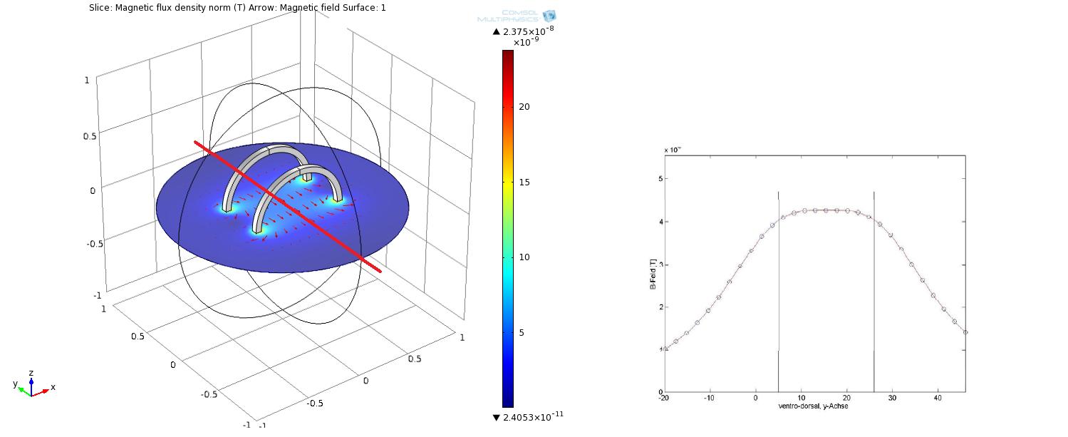

Hallo , I need help on how to visualize and analyse results, i took the example from the model library + ACDC module + electrical components + Helmholtz coil
When I look at the results I get the magnetic field generated by this coils, my question is , how do I get the data from only one line going through the Y axis, starting point (0,-1,0) ending point (0,1,0)
I attatch a picture of the graph that I want to get , can comsol generate such a graph or at least give me the data on each point of the line so i can make the graph on my own..
Thanks for your help =)

Hi Ricardo
Try a right click on the Result Data Set node (get used to try a right click on all nodes, even when you believe you know them as new items appear depending on how you define the previous ones !) and try a cut line, or an edge etc. Then redirect you plot (line plot probably) onto this "data set"
