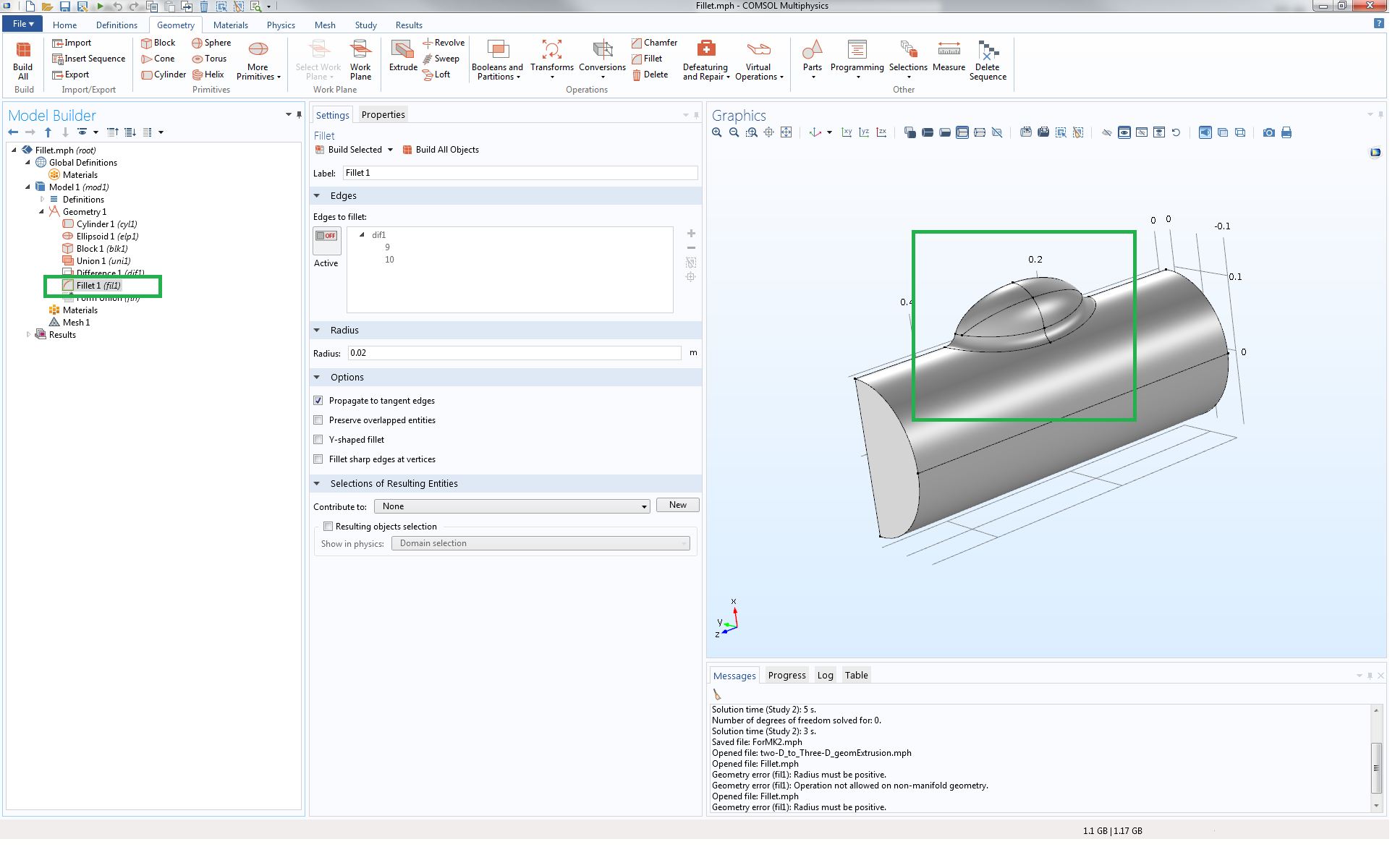

Is there a way to add a fillet to the common edge of the cylinder and ellipsoid in the attached file (Comsol 4.2a) other than exporting the geometry, open it in a CAD software, add the fillet and export it again? I tried for a while using a 2D workplane where the function "fillet" is available to generate the fillet in 2D and then sweep it along the common edge of the cylinder and the ellipsoid in 3D, but without success (Comsol does not manage to create a union at the end).
Adding a fillet in 3D seems to me like a basic feature which is available in any CAD software.
Thanks for any help.

Indeed adding a fillet seems easy, in fact it's topologically tricky, and I have too noticed that the fillets are only available in 2D in COMSOL.
I mostly use my external CAD programme as that goes much quicker for complex volumes, then I add if required only spheres and cubes with Comsol, once the CAD is imported, i.e. to mimic an air volume, or to close the caps of a tube
There are ways to get around, for many cases, by union and differences, but it takes some time to figure out the riht way for different cases, and not always on our line of priorities.
Personally, I prefer to have COMSOL excellent on physics and FEM, and poorer on CAD, as I would never use COMSOL for my mechanical drawings, anyhow so why pay twice ? ;)

I tried your suggestion by defining the profile of my fillet on a sketch, and then sweep this profile along the edge to be filleted. Unfortunately, this did not work because the edge to be filleted does not present a constant geometry (the fillet needs to adapt in function of the angle between the two faces defining the edge).
But I found out that the radius of a fillet is also available via a variable in SolidWorks. For a dimension in a sketch, you would typically use "MyLength@sketch1" in Comsol. For a fillet, you can use "D1@fillet1" (where fillet1 is the name of your fillet). It's as simple as that :-)
