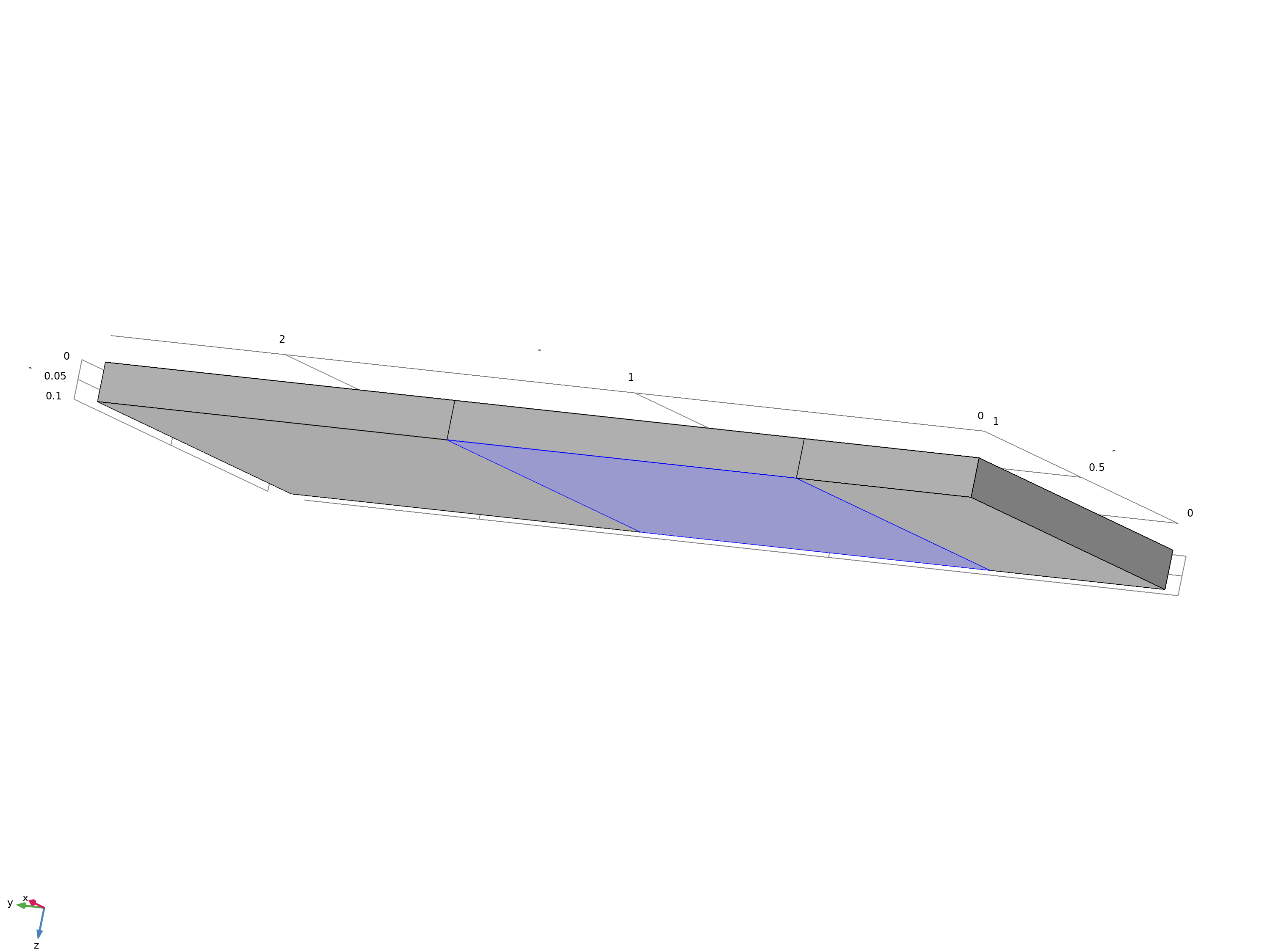

- Geometry (see geometry.png) -> a defined flux is applied at the surface. This flux was originally defined by a square pulse (for testing purposes the flux is constant)

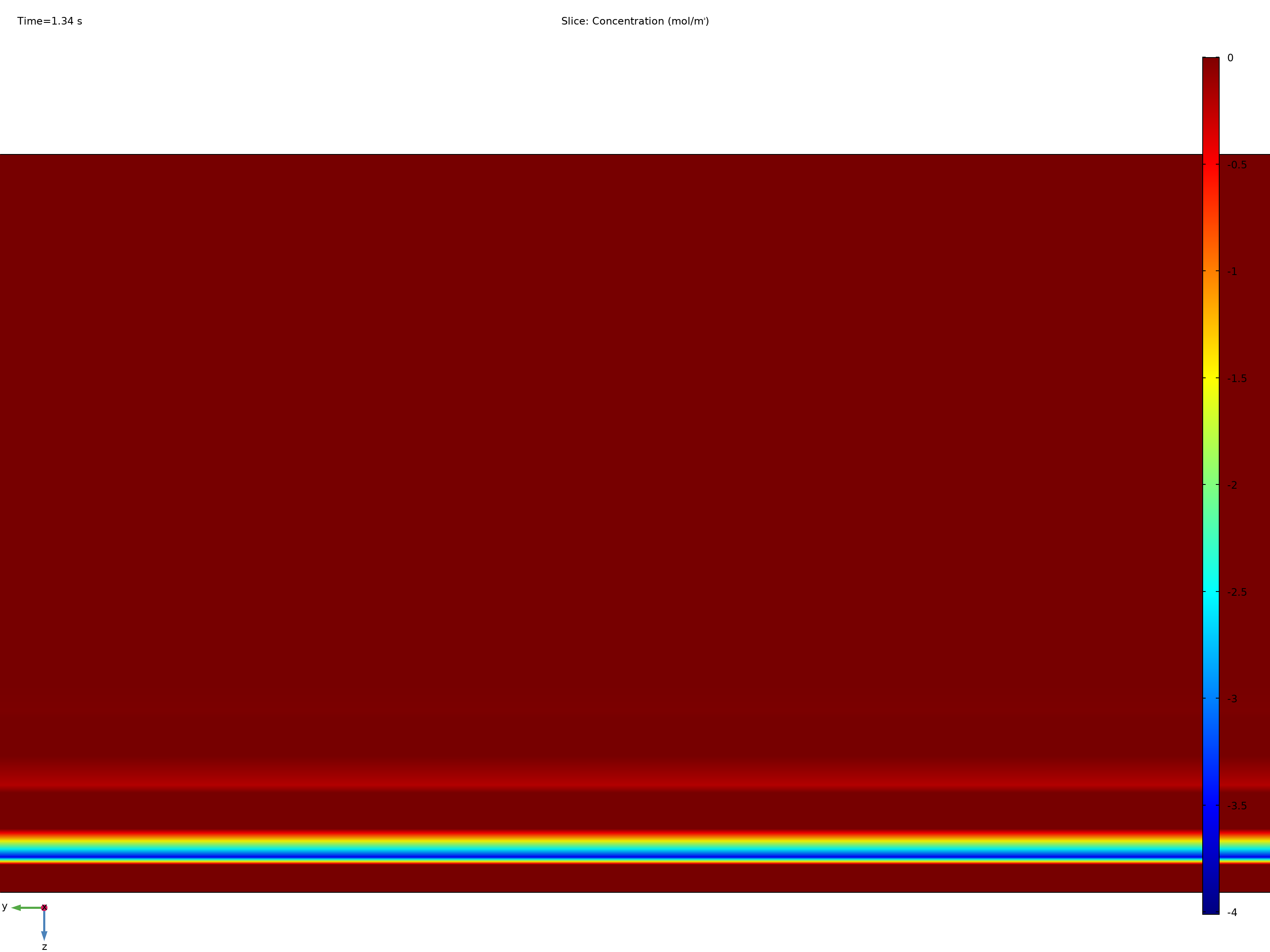

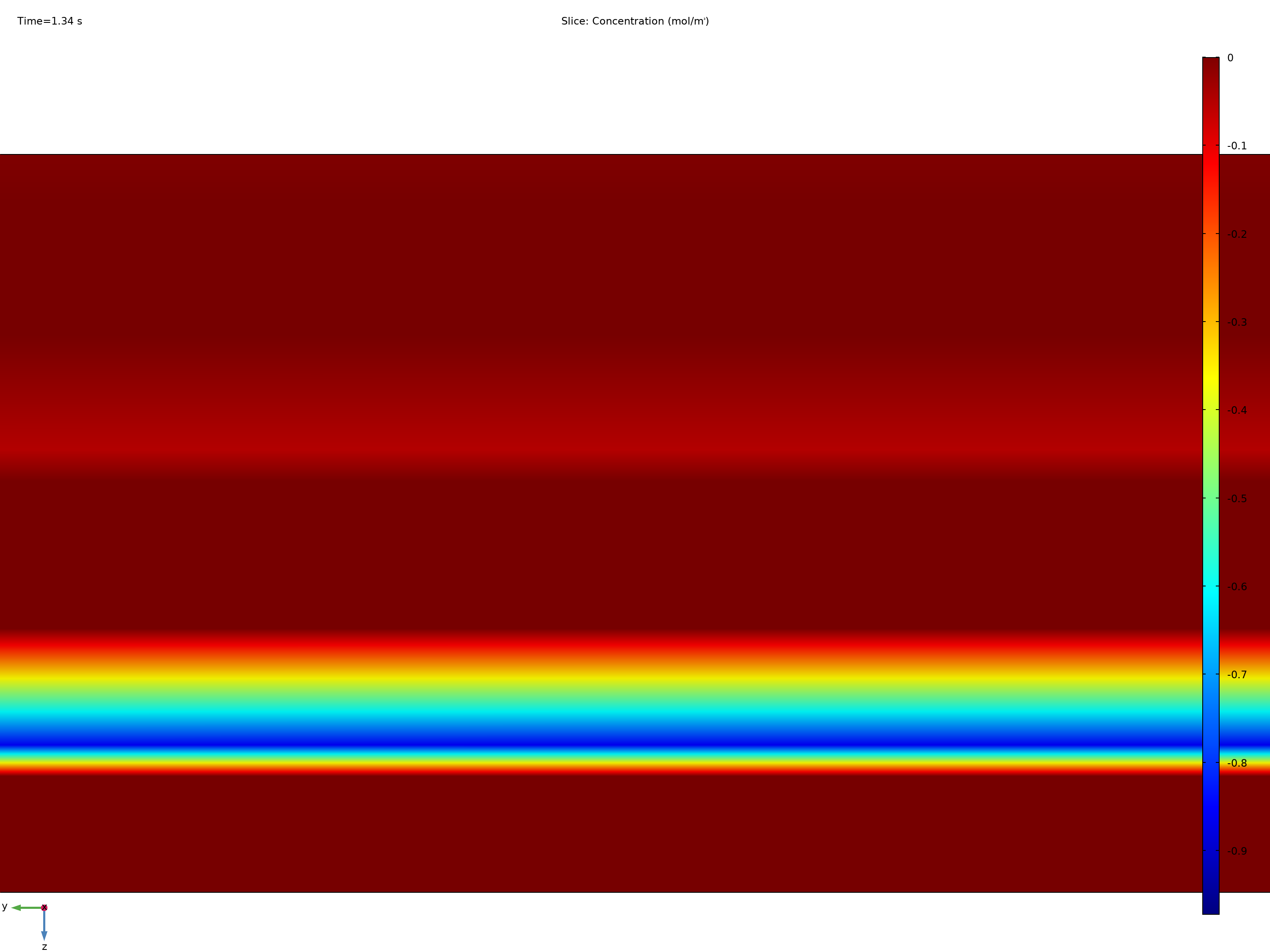

- There is a zone of negative concentration above the surface where the flux is set

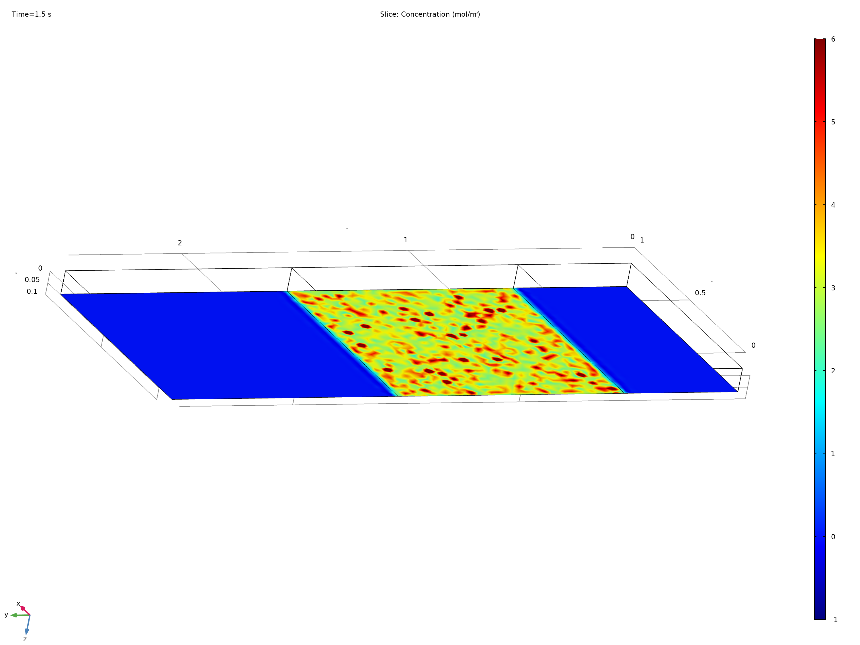

- The concentration on the surface where the flux is applied has not a uniform concentration.
What did I try to resolve this:
- Change the mesh. I used the standard mesh from comsol and two custom quad meshes different accuracy. Concentration profiles from the quad-meshes are attached. It seems that the mesh quality only compresses/shifts the negative concentration zone.
