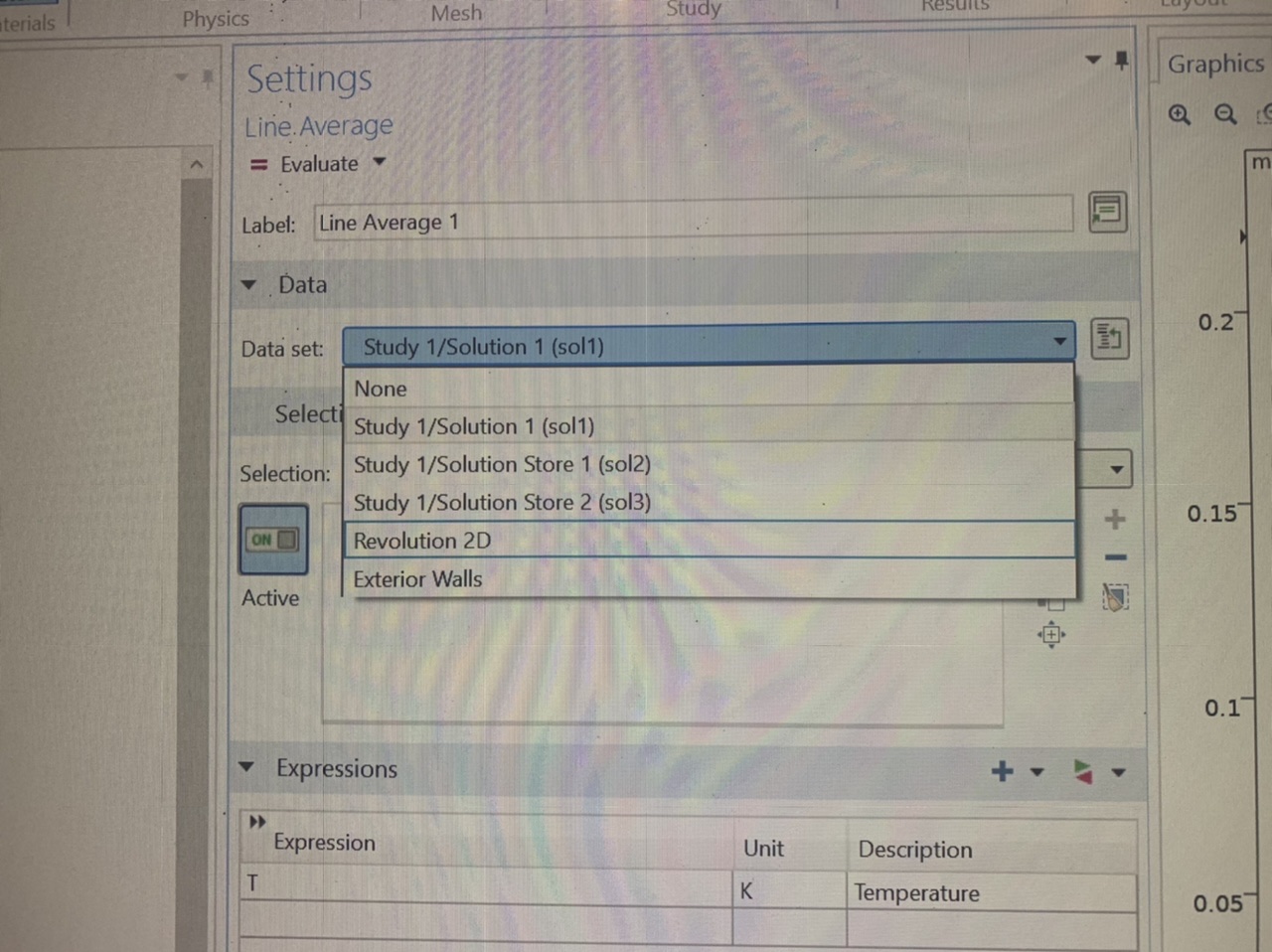

The Solution Store items contain the results from study steps other than the last. So, it seems like you have three study steps within your study. You can actually see the Solution Store nodes in your solver sequence, as in the attached screenshot.
As an example: If you solve a stationary study steps to provide initial values for a time-dependent study step, the stationary results will be available in a Solution Store data set.
Henrik

                                                    So in order to get the final and full answer, i should choose study1/solution1 am i correct?

                                                    Yes
