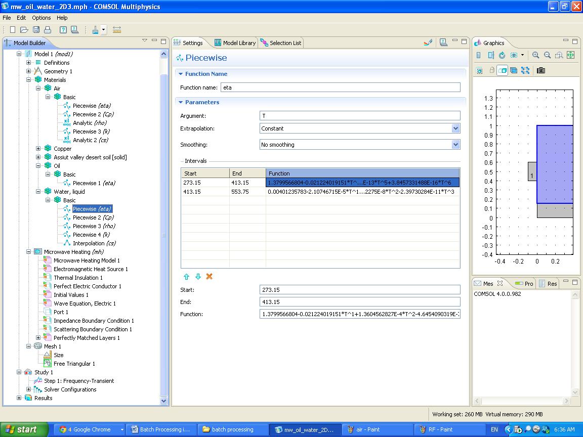

Hi Sohan,
The dielectric for water i.e. 78-11*j, is it incorporating the fact of change in dielectric constant with the increase in temperature?
In addition do you know about the dielectric constant for crude oil?
I am trying to heat oil with the microwaves heating (RF module) using version 4.0 of COMSOL, but the temperature distribution which I am getting is very huge as compared to the real word and it is also confined to the area adjoining the microwaves port. In real word scenario, temperature should reach a few hundered degree celsius in heating for a day almost and also temperature distribution should be present at a distance say 50% wayay from the source inside the material. Although it will be small but it will be there. In my case I am getting temperature distribution of a few thousand degree Celsius near the port and confined in almost 10 cm distance from the source, which is strange for me.
Can you suggest any potential reason behind this?
Many thanks in advance for any feedback!

Hi Timo,
Have you solved your problem?
I am a new user of COMSOL and getting almost similar errors as you did?
I will appreciate any of your help.
Thanks in advance.

Muhammad:
If the temperature is localized near the source even after a long period of time (1 day as you mentioned) then your thermal diffusivity may be incorrect. Check the thermal conductivity and the specific heat capacity of the crude oil.
Timo:
One simple way to approximately capture the effect of the latent heat of vaporization is to sharply increase the specific heat capacity over a narrow temperature range (around the boiling temperature) such that the additional area under the specific heat-temperature curve equals the latent heat. No multiphase flow required, and no fluid phase change. Again it’s an approximate solution, so it’s not suitable for all problems. However, I found it useful for several applications.
Nagi Elabbasi
Veryst Engineering
Muhammad: If the temperature is localized near the source even after a long period of time (1 day as you mentioned) then your thermal diffusivity may be incorrect. Check the thermal conductivity and the specific heat capacity of the crude oil. Timo: One simple way to approximately capture the effect of the latent heat of vaporization is to sharply increase the specific heat capacity over a narrow temperature range (around the boiling temperature) such that the additional area under the specific heat-temperature curve equals the latent heat. No multiphase flow required, and no fluid phase change. Again it’s an approximate solution, so it’s not suitable for all problems. However, I found it useful for several applications. Nagi Elabbasi Veryst Engineering

Do you mean to say that I have to define thermal conductivity and specific heat capacity as a function temperature as for the time being I am just defining them as constants e.g. thermal conductivity=0.04299(W/m*K) and Heat Capacity at Constant Pressure as 2130(J/Kg*K).
I am also interested in getting the dynamic behavior of oil with the change in temperature, can you please suggest something how can I obtain it?
Many thanks in advance!

Yes, you should account for temperature dependence for all relevant properties, since you are talking about significant temperature increases. It may well be that at higher temperatures the thermal conductivity is higher. Evaluating the temperature dependence is another challenge!
Also at high temperatures the viscosity of oil drops and could reach a point where the heat transfer through natural convection becomes significant. In that case, you should setup your model to account for natural convection if you haven’t done so already.

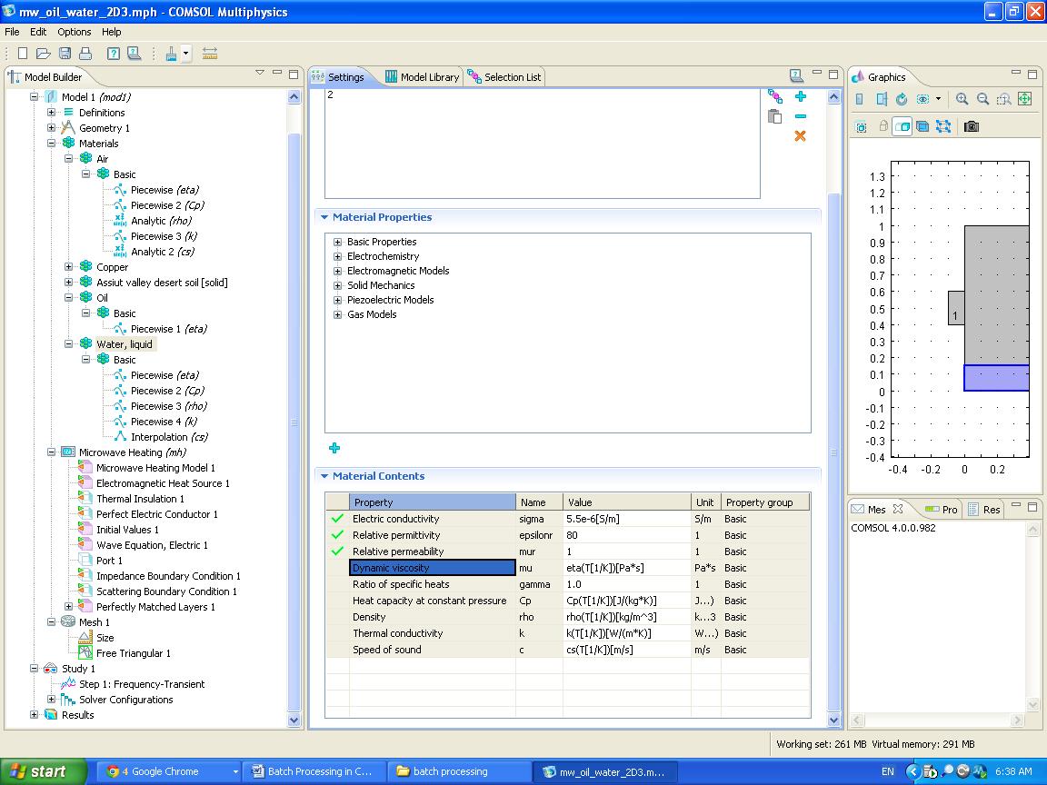

I am trying to find out some relationship of viscosity with temperature and thermal conductivity plus dielectric constant with temperature. But some one suggested me to define the material properties in the way being defined by the built in materials, please find attached the images (water1.jpeg for the properties shown for water defined as built in function, highlighted is the dynamic viscosity, second image is function of temperature.jpeg and shows how dynamic viscosity has been defined as a function of temperature). I am not sure how to incorporate such functions in my model for oil, can you please suggest some thing?
Secondly as you mentioned that at high temperatures, viscosity drops much and the natural convection should also be incorporated. If I find some temperature -viscosity relationship for oil and include it in the model for oil properties, will it not cover this phenomenon of natural convection? Should I have to include it as another parameter or function?
Many thanks for your feedback!

Instead of providing linear regression equation in piece-wise function, you can use interpolation as it was done for speed of sound properties of water.
For taking into account of the convention, you need to use solve Navier-Stokes equations. I would recommend you to first set the RF physics right as convection will not change your microwave power distributions in the domain. alter on you can add up more physics.

After getting the heat dissipation with electromagnetic model, how can I change the properties of material?
As far as I think, the file will be the same and material properties will also remain same. I can change the study but how can I change the properties of material for second study?
In addition, how can I use this heat dissipation (obtained in case of electromagnetic heating) as initial stage for the heat conduction and convection model of second study?
This is the main problem: how to change the properties of material for second study while keeping the results of first study as initial conditions for second study?
I will really appreciate your response.
Many Thanks for your time.

You can change the material properties between studies. What COMSOL will take from the EM study is the heat generation. If your thermal conductivity changes in the second study, there is no problem.
If the dielectric properties of the oil however vary with temperature then you cannot solve for the EM field just once. You can leave out that level of complexity until you have worked out the other issues. Build up the model complexity gradually as Sohan described.
Also, including viscosity by itself in a fluid flow model does not account for natural convection. You need to couple the fluid flow model to the heat transfer one, and account for convection using the Boussinesq approximation or something similar (there are some relevant examples in the COMSOL model gallery).

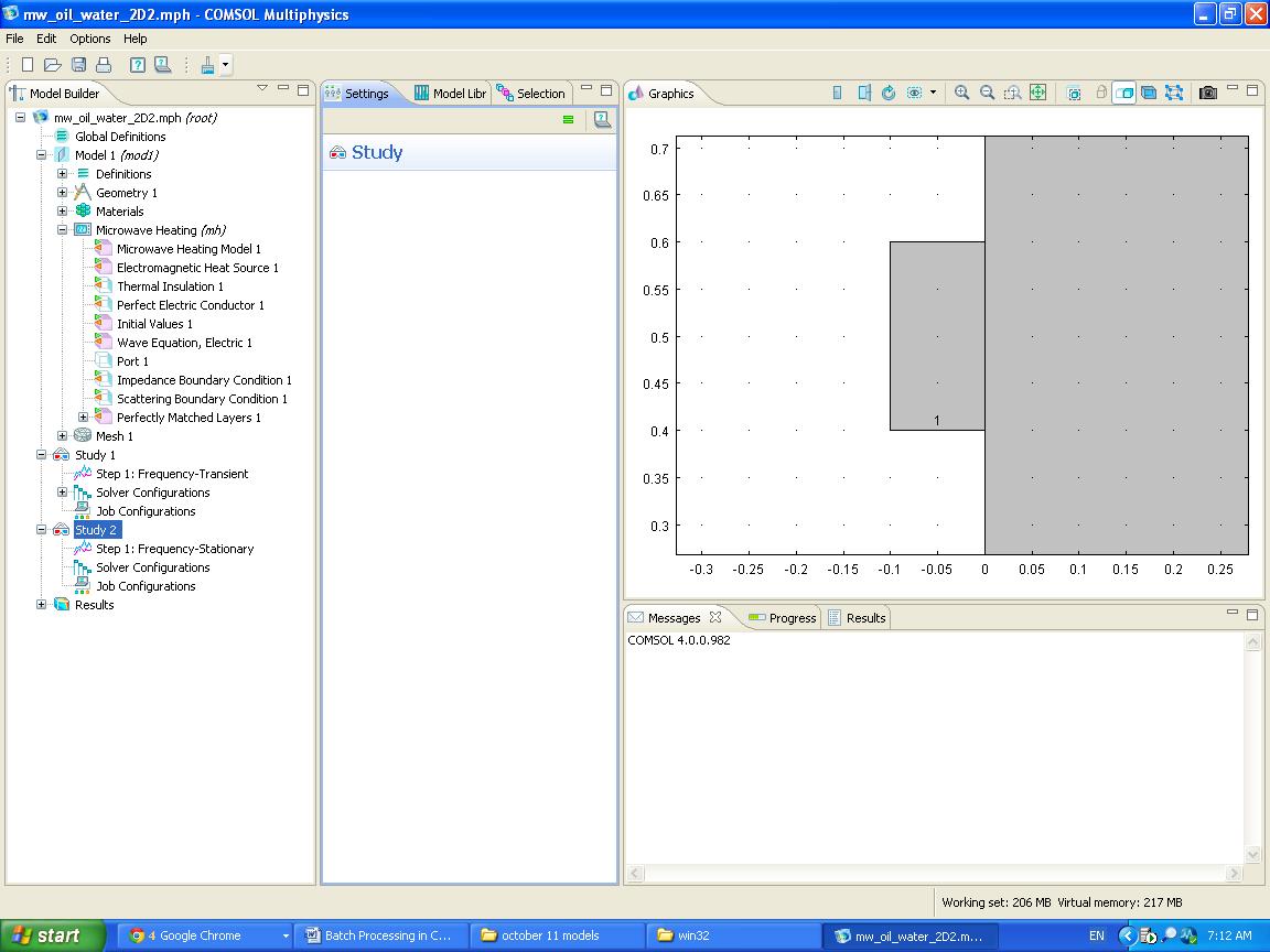

I tried to setup an other study but I have the properties of the materials as the same as you can see in the attached image. I want to run the first study with some settings of the material and then use the result of first study as base point for the second study.
If I proceed with simulation of first study and then change the settings of material properties manually and carryout the second study, is it the same what I want? I mean is COMSOL using the results of my first study as starting point or initial conditions for the second study, if not then how can I do that?
For the dielectric constant change with temperature, if I define my dielectric constant as interpolation function by inserting a table (different dielectric strength for different temperature) in the input of dielectric properties of oil, and simulate isn't it being considered as dynamic dielectric constant by COMSOL? Will the results of my simulation will incorporate the change in dielectric strength?
Thanks a lot once again for your time and support, JazakAllah!

There is no need to simulate frequency-stationary study. Instead of it, I recommend you to add RF module and perform study with frequency domain solver. This will take material properties at initial temperature. Once you get satisfactory result showing power density, solve the coupled MW heat transfer using transient solver.
Sohan

There is no need to simulate frequency-stationary study. Instead of it, I recommend you to add RF module and perform study with frequency domain solver. This will take material properties at initial temperature. Once you get satisfactory result showing power density, solve the coupled MW heat transfer using transient solver. Sohan [QUOTE] Thanks a lot brother for your answer! I tried to setup an other study but I have the properties of the materials as the same as you can see in the attached image. I want to run the first study with some settings of the material and then use the result of first study as base point for the second study. If I proceed with simulation of first study and then change the settings of material properties manually and carryout the second study, is it the same what I want? I mean is COMSOL using the results of my first study as starting point or initial conditions for the second study, if not then how can I do that? For the dielectric constant change with temperature, if I define my dielectric constant as interpolation function by inserting a table (different dielectric strength for different temperature) in the input of dielectric properties of oil, and simulate isn't it being considered as dynamic dielectric constant by COMSOL? Will the results of my simulation will incorporate the change in dielectric strength? Thanks a lot once again for your time and support, JazakAllah! [/QUOTE]

Muhammad Mohsin Rehman
Posted: 1 decade ago 27.11.2011, 07:43 MEZ
Thanks a lot Sohan,
Unfortunately I am unable to open the file you sent as I think because of the version (I am using version 04a).
I did the same as you suggested. I have a 2D rectangular port and one of its boundaries is excited by using the input Power of 50 KW, Electric field as Ex=0, Ey=0 and Ez=cos(pi*y/0.062[m])[V/m]. Then comes the propagation constant beta which has been defined as: 2*pi/c_const*sqrt(freq^2-c_const^2/(4*0.062^2))
This is just in the same way as it was defined for microwaves oven model. Now when I simulate a layer of oil and a layer of water connected together then I get some temperature distribution but when I define one layer of water as sandwiched between two layers of oil, in that case it gives the error mentioned below. Can you please suggest something, what could be the potential cause of this error and how it can be rectified. By analyzing the error, I have come to know that it is related to E field because it is mentioning mod1.E10,20 etc. and secondly it has something to do with the layer of water as the co-ordinates mentioned are referring to the location where the layer of water is located. But I am not sure what kind of error is it. Can you please elaborate what E-field can be defined reasonably for a 2D wave guide? In addition, what should be the boundary condition between oil and water normally?

Rehman,
It looks like you are stuck with the COMSOL approach which they use for developing MW oven library model. One has to understand why did they took only half model and created those complicated input equations. Only reason of created that model is to reduce the size so that user can run at least that model on laptops.
When you use complete 3-d model or 2-d model you do not necessarily need to provide E-field value and cutoff frequency. You simply select rectangular port type and plug in input microwave power.
I am puzzled why do not get answer when you sandwich water in between oil layer.
To troubleshoot the problem, first assign same properties (oil or water) to all layers and run the model. If it runs for both material properties then it is not the issue with material properties.
How did you create those layers?. Make sure you have activated union instead of assembly in geometry creation.
If problem still persists, send me your model file, I can quickly look in it.
With best wishes,
Sohan

I have checked for every boundary and domain and it seems good to me but still I am not able to get the heat distribution. I have also activated the union. Layers have been defined just as rectangles with different dimensions.
Please have a look on the attached model and rectify me where I am wrong.
Thanks for the feedback once again!

Assalam o alaykum brother,
I am also trying to convert water into steam at a specific temperature (say 100 degree Celsius). I could not find any latent heat of vaporization in COMSOL and was wondering how can I define it.I have just a block of water and I am heating it with microwaves. It should absorb the heat and water should be converted to steam.
I also tried to change the specific heat capacity of water as suggested by you to Timo last time but on checking its specific heat capacity I found it defined as piece wise format:
Start 273.15 , End: 553.75 and Function: 12010.1471-80.4072879*T^1+0.309866854*T^2-5.38186884E-4*T^3+3.62536437E-7*T^4
How can I change this expression for it to include specific heat capacity very high near the boiling point of water?
Can you please suggest some thing?
Thanks.

Posted: 1 decade ago 28.12.2011, 03:12 MEZ
There are several ways to do that. One way is to add to Cp a built-in “Rectangle” COMSOL function that acts around 100 Celsius (say from 98 to 102). The function value should be zero below 98 and above 102, and equal to the latent heat divided by 4 between 98 and 102. Make sure as Ivar mentioned to select a smooth function and make sure also that the time stepping is small enough to not skip over that narrow temperature range.
Nagi Elabbasi
Veryst Engineering
There are several ways to do that. One way is to add to Cp a built-in “Rectangle” COMSOL function that acts around 100 Celsius (say from 98 to 102). The function value should be zero below 98 and above 102, and equal to the latent heat divided by 4 between 98 and 102. Make sure as Ivar mentioned to select a smooth function and make sure also that the time stepping is small enough to not skip over that narrow temperature range. Nagi Elabbasi Veryst Engineering
