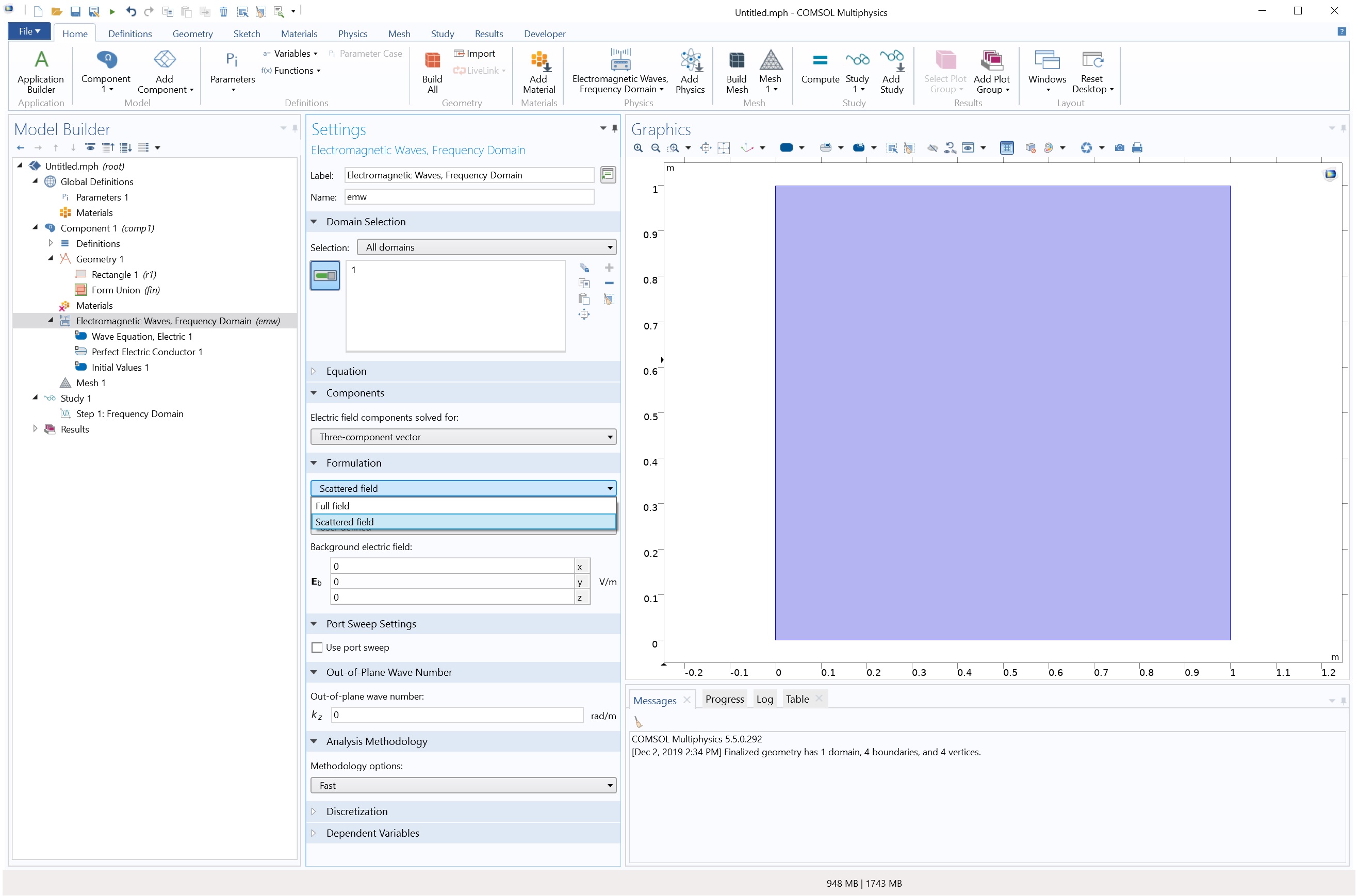

Consider using the wave-scattering formalism, instead of ports. You can specify the components of the incident wave. See the attached screen shot for where to do that.
Consider using the *wave-scattering formalism*, instead of ports. You can specify the components of the incident wave. See the attached screen shot for where to do that.

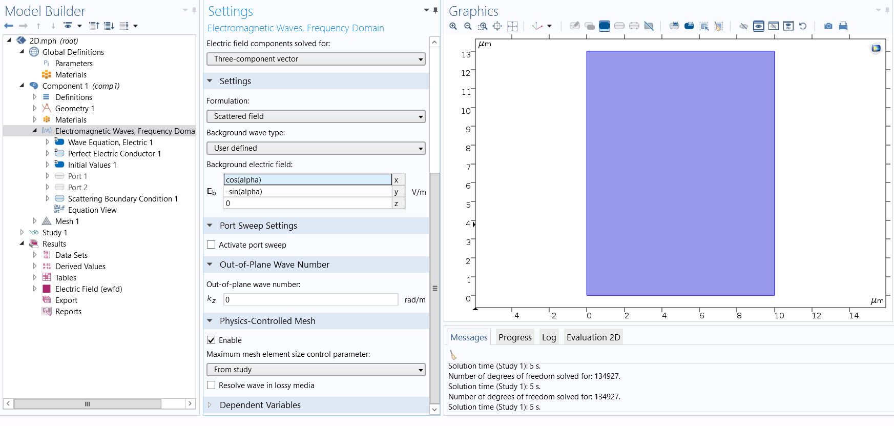

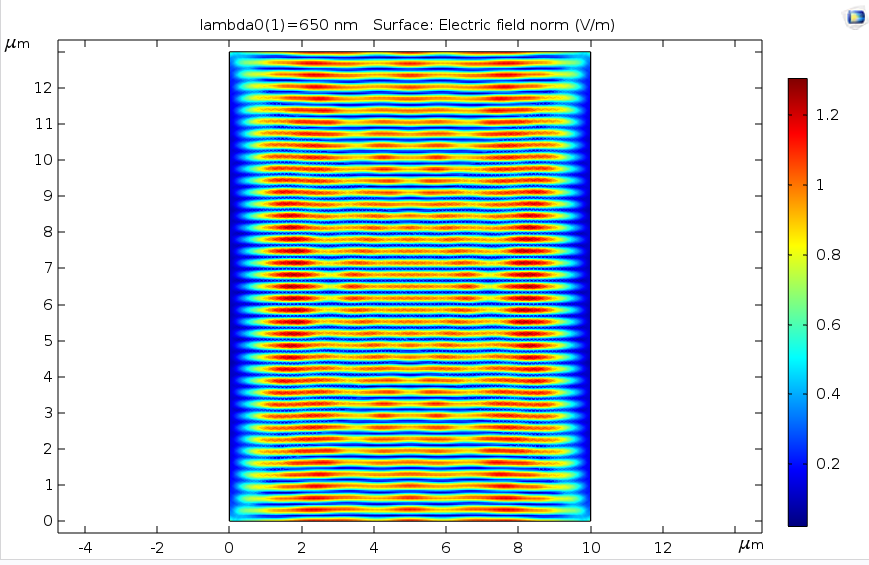

Thank you for your help! I've tried to go down this route to see if it works. I've disabled both ports, and specified all sides to be Scattering Boundary Conditions. However, I believe that it still behaves oddly. I've attached a picture of my wave-scattering settings. I've also attached the results of the electric field pattern for normal incidence (alpha = 0), and oblique incidence (alpha = 30 degrees, approproately converted to radians). The normal incidence seems (somewhat) plausible, but I'm not quite sure about the oblique case.
My thought process was to manipulate the components of the background electric field to depend on the angle in a way that the wave will propagate normal to the electric field. Am I on track?
Thanks!
Hi, Thank you for your help! I've tried to go down this route to see if it works. I've disabled both ports, and specified all sides to be Scattering Boundary Conditions. However, I believe that it still behaves oddly. I've attached a picture of my wave-scattering settings. I've also attached the results of the electric field pattern for normal incidence (alpha = 0), and oblique incidence (alpha = 30 degrees, approproately converted to radians). The normal incidence seems (somewhat) plausible, but I'm not quite sure about the oblique case. My thought process was to manipulate the components of the background electric field to depend on the angle in a way that the wave will propagate normal to the electric field. Am I on track? Thanks!
