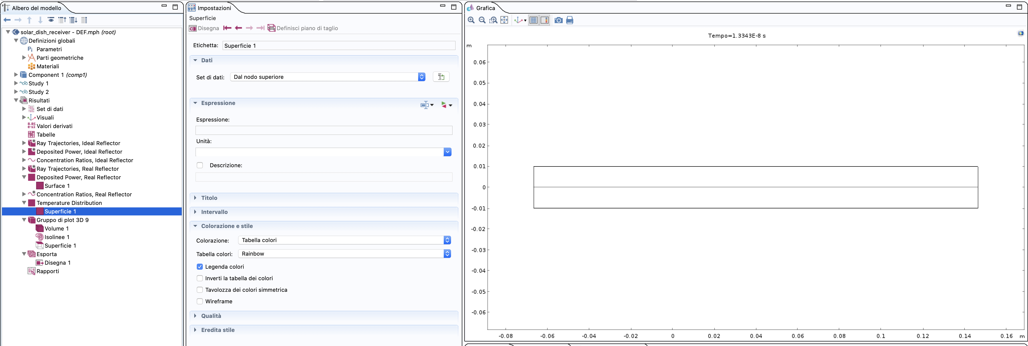

I have a question regarding the solar dish model: is it possible to evaluate the temperature distribution in the focal plane? I noticed that in the “Results” section, by adding “2D plot group”, a temperature map ("Temperature distribution") of the focal plane can obtained, but it is necessary to insert a specific formula in the form “gop.wall1.bsrc1……”. Do you know the exact expression that should be written?
Thanks for your help
