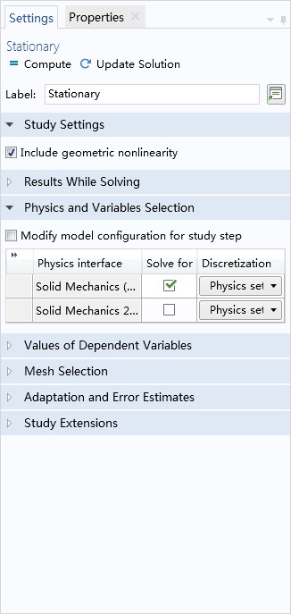

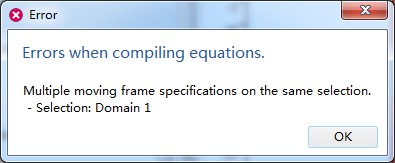

Thank you Henrik. When I choose spatial frame and geometric nonlinearity at the same time, COMSOL will encounter a problem that is "Multiple moving frame specifications on the same selection." I donot know why.
>Hi, > >This depends on whether you evaluate the integral in the material frame or the spatial frame. > >To compute integrals in the deformed configuration, you must either select spatial frame when defining the integration operator (if you are using one), or select spatial frame in the dataset. > > >Regards, >Henrik Thank you Henrik. When I choose spatial frame and geometric nonlinearity at the same time, COMSOL will encounter a problem that is "Multiple moving frame specifications on the same selection." I donot know why.

If you select Modify model configuration for study step, you can identify the conflict, and also resolve it.

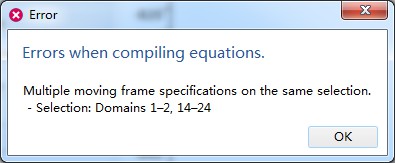

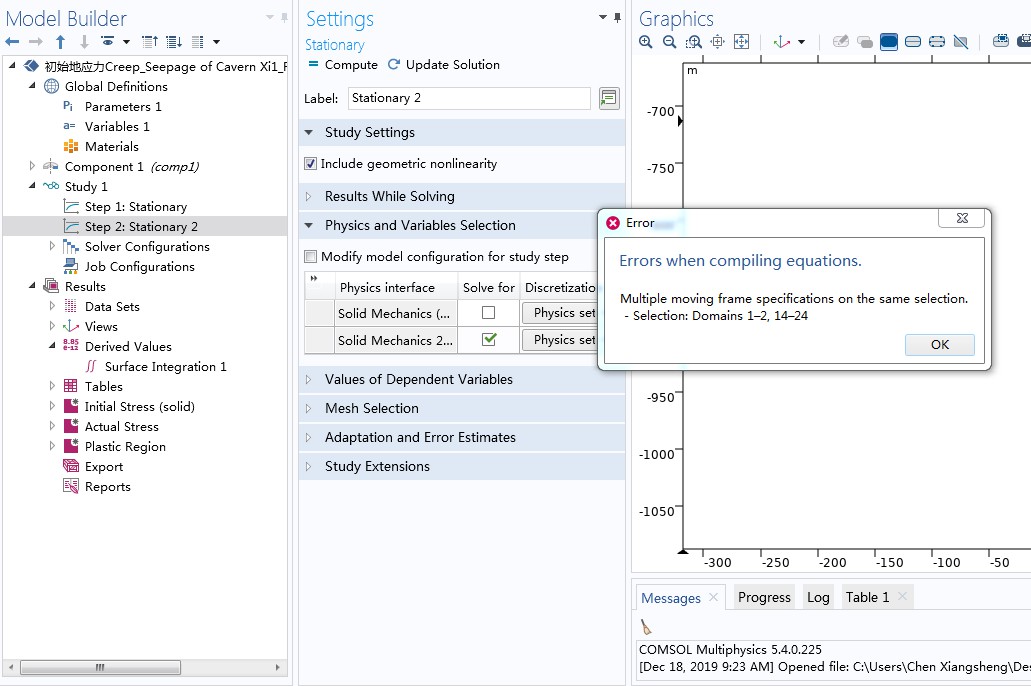

Dear Henrik, I am sorry to bother you again. Because it failed again in the calculation. I think the geometric nonlinearity must be opened to solve the area and volume after model deformation, but the model keeps showing errors. This model is an official case, I am very confused about that. Thank you.
