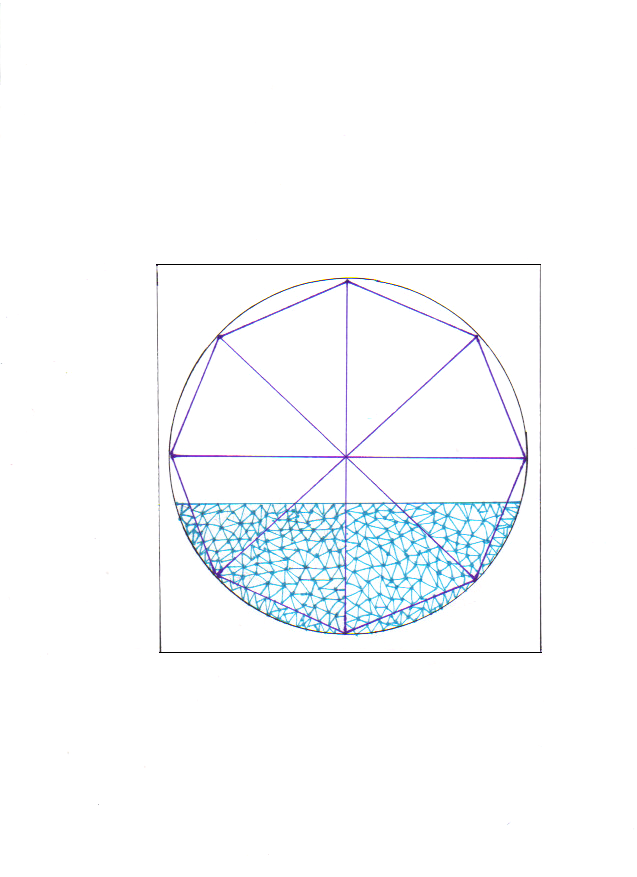

We want to model a front load washer partially filled with water as shown in the attached Cross Section 3 screen shot.

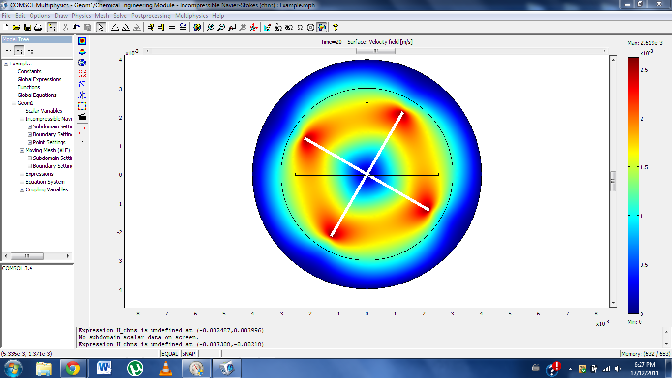

We formed our base model off of the schematic pump 1 example in the model library of COMSOL 3.4 (see attached mixer model screen shot). The problem with this model is that the mixer is entirely full of water, and the model we are trying to create (the front load washer) is only partially full of water.
Is it possible to model a partially full mixer?

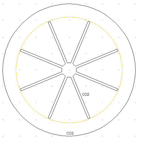

On a side note we tried to run the Schematic Pump #2 by just changing the impeller geometry and the model would not converge. The same boundary conditions are applied and the outer geometry remains relatively the same (the inlet and outlet is removed ... which converged with the original impeller) it is just the impeller has more blades and is larger as shown in the picture attached. Does geometry have that much of an effect on the model converging?
Thanks for your reply Ivar, We looked at the sloshing tank example initially as we are not concerned with motion of the air in the system (we would assume that the water behaves as one cohesive unit). However, we ran into difficulties in modeling the water sloshing in a closed system. First, it was difficult to define the boundary of the system to be circular using tangential and normal coordinates. Second we found that if we increased the max displacement angle (phi) the sloshing tank example would not converge. As we want the fluid to rotate in the closed system this caused some concern. Returning to the drawing board we looked at the Schematic Pump #2 example in the Chemical Engineering Module. This is simply exactly what we want to model but without and inlets and outlets and with the pump to be half full. However, I could not find any examples of mixing two fluids or water and air, hence, we are still stumped. On a side note we tried to run the Schematic Pump #2 by just changing the impeller geometry and the model would not converge. The same boundary conditions are applied and the outer geometry remains relatively the same (the inlet and outlet is removed ... which converged with the original impeller) it is just the impeller has more blades and is larger as shown in the picture attached. Does geometry have that much of an effect on the model converging?
