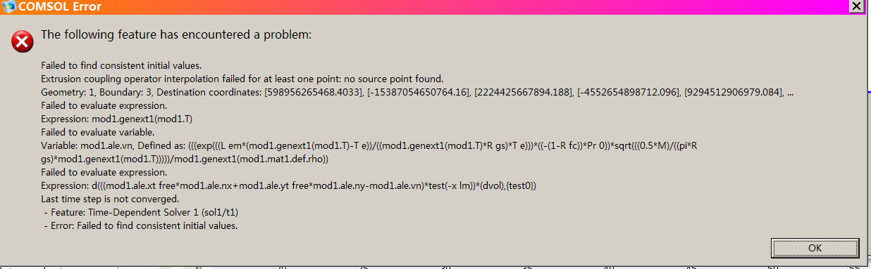

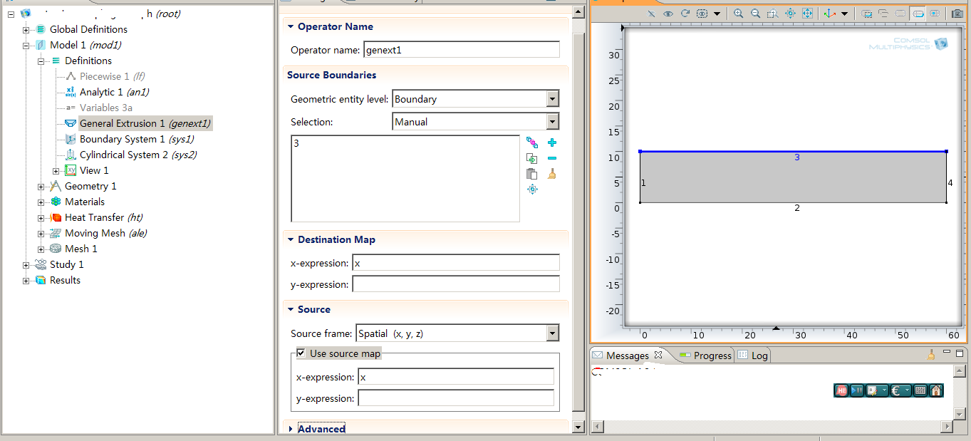

I have defined a general extrusion coupling operator to obtain the dependent variable (in my heat transfer case, the temperature "T") at a boundary. the setting of the extrusion is shown in the attachment (the .PNG file ).
when i solve my model, the following error occurs. could you give me some guidance?
Failed to find consistent initial values.
Extrusion coupling operator interpolation failed for at least one point: no source point found.
Geometry: 1, Boundary: 3, Destination coordinates: [4.452806170061471e+021], [4.456088152789275e+021], [-6.161457555631103e+020], [-8.411254597429331e+020], [-9.319635436176123e+020], ...
Failed to evaluate expression.
Expression: mod1.genext1(mod1.T)
Failed to evaluate variable.
Variable: mod1.ale.vn, Defined as: ((sqrt(((0.5*M)/(mod1.genext1(mod1.T)*(R gs*pi))))*(exp(((L em*(mod1.genext1(mod1.T)-T e))/((mod1.genext1(mod1.T)*R gs)*T e)))*(Pr 0*(-(1-R fc)))))/mod1.genext1(mod1.mat1.def.rho))
Expression: d(((mod1.ale.xt free*mod1.ale.nx+mod1.ale.yt free*mod1.ale.ny-mod1.ale.vn)*test(-x lm))*(dvol),{test0})
Last time step is not converged.
