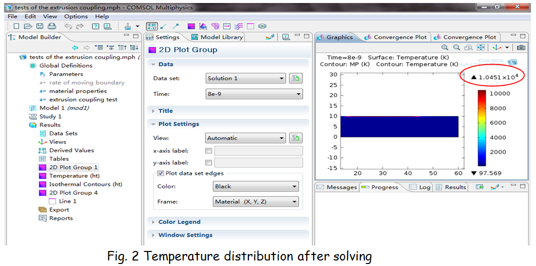

Fig. 2 shows the resultant temperature distribution. Because there is heat flux (BC) on the upper boundary, hence the maximum temperature should locate on this boundary.

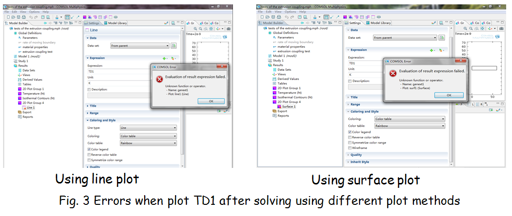

However, I try to plot “TD1” using line plot and surface plot, only to fail. Fig. 3 shows the results and errors when plot the “TD1” using line and surface plot. In Both situations, the
“Unknown function or operator
-Name: genext1
-Plot: surf1 (Surface)”
error occurs. I am quite puzzle with it. I have defined the global variable “TD1” using the genext1 (general extrusion) operator, and plot the global variable, but fails. The extrusion operator can create a global quantity which can be used in other model. Can it be used in the global definition? This is my first question, thanks for your help.

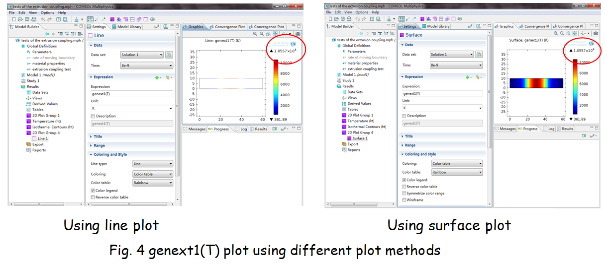

Afterward, I try to use the “genext1(T)” in the expression instead of T (which is defaulted), and both plots using line and surface plot are ok, just shown in Fig. 4. But after a careful look, the so called boundary temperature (upper surface temperature) is different from the one shown in Fig. 2. The maximum temperature at the upper temperature is 1.0451 X 10e4, while the one obtained through the extrusion operator is 1.0557 X 10e4. The gap (105K) is a little big. I haven’t understood the underlying reason and mistake. Could you give me some guidance?
Question one:
Can the extrusion operator be used in the global definitions?
If can, why I can’t plot after solving?

Why there is a big difference between the actual/theoretical temperature and the one obtained through the extrusion operator?
