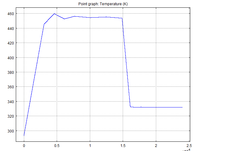

hi everyone.
I am doing transient heat transfer analysis in which the boundary conditions would change with respect to time.I am using interpolation function to give time varying boundary condition.It works well. But , while plotting the results at the boundary (after solving, using point plot) , getting spikes in the plot. How to correct it ?. or can you tell me the correct method to define functions?

these can come from many issues: insufficient mesh density, to coarse interpolation elements, time sequence versus mesh density not respecting the Fourier number limits, numerical oscillations due to scaling or even smoothing issues in the postprocessing, many to choose from ;)

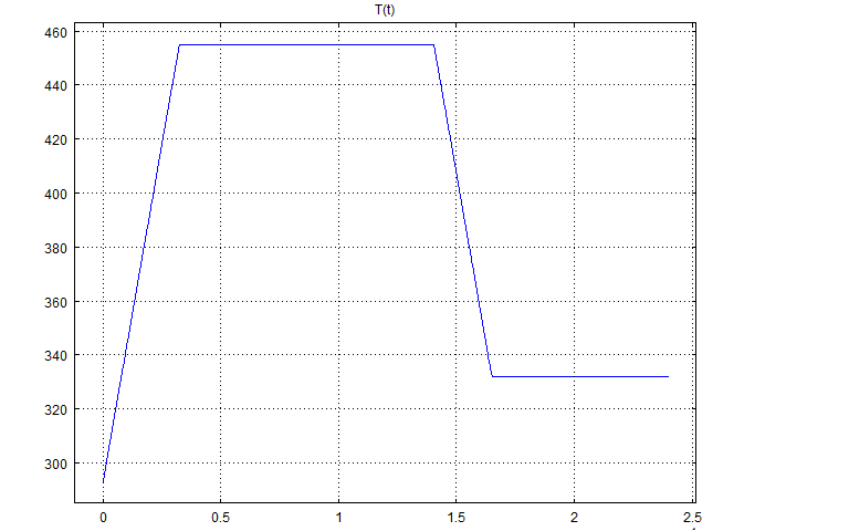

thank you for your reply. I am doing like this. First import my text file in interpolation function(and plot it , which already shown to you). I use int1(t[1/s]) in the initial temperature field(means using temperature BC).I am using fine mesh only. In the interpolation filed I use linear, extrapolation field I use constant, in time dependant field I use range(0,1,24000)s.
and my input text file is attached with this and material is aluminium.
Apart from this where I am making mistake? Since I am new to comsol, I am feeling hard to find it.
hi ivar thank you for your reply. I am doing like this. First import my text file in interpolation function(and plot it , which already shown to you). I use int1(t[1/s]) in the initial temperature field(means using temperature BC).I am using fine mesh only. In the interpolation filed I use linear, extrapolation field I use constant, in time dependant field I use range(0,1,24000)s. and my input text file is attached with this and material is aluminium. Apart from this where I am making mistake? Since I am new to comsol, I am feeling hard to find it.

int1(t[1/s]) corresponds to "t*volume" (if in 3D) or "t*area" (if in 2D) of your domain so this is a particular BC condition, not sure I understand it though.
Fine mesh is not enough as it's the mesh density in the required regions with high T gradients that counts, so even a "coarse" mesh could be perfectly OK, it depends also on your time steps, linked via the Fourier number Fn = alpha*delta_time_step/h^2 where h is the local mesh average size and alpha the thermal diffusivity alpha = k/rho/Cp of your "material"
With a time step of 1 seconds you will store 24000 solutions, that is a lot ! you will probably get a few Gb files.
As the general solution of a thermal flux case is often following an erfc() function exponential law, often you can use a log time step or a power time step i.e. 10^{range(-1,0.5,4.5)} or perhaps a 2^{range(-1,1,15)} (again it depens on the details of your model), use the thermal diffusivity to estimate the time to get to an equilibrium, check your thermal conduction reference books.
Hi int1(t[1/s]) corresponds to "t*volume" (if in 3D) or "t*area" (if in 2D) of your domain so this is a particular BC condition, not sure I understand it though. Fine mesh is not enough as it's the mesh density in the required regions with high T gradients that counts, so even a "coarse" mesh could be perfectly OK, it depends also on your time steps, linked via the Fourier number Fn = alpha*delta_time_step/h^2 where h is the local mesh average size and alpha the thermal diffusivity alpha = k/rho/Cp of your "material" With a time step of 1 seconds you will store 24000 solutions, that is a lot ! you will probably get a few Gb files. As the general solution of a thermal flux case is often following an erfc() function exponential law, often you can use a log time step or a power time step i.e. 10^{range(-1,0.5,4.5)} or perhaps a 2^{range(-1,1,15)} (again it depens on the details of your model), use the thermal diffusivity to estimate the time to get to an equilibrium, check your thermal conduction reference books. -- Good luck Ivar

thank you for your suggestions.Its working fine with the 10^ and 2^ time steps. But I need more details about verification and validation of models. Can you tell me the guidelines to model a good physics ? Because I feel that comsol documentation is not in detail , for beginners like me its hard to get inputs from that.
