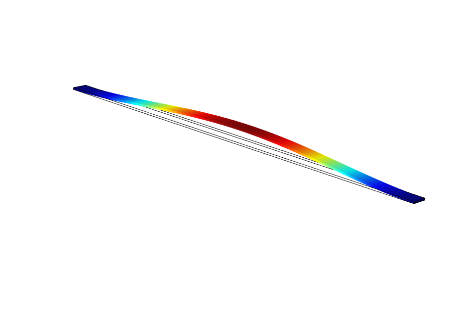

I'm trying to see the resonant mode and resonant frequency of doubly-clamped beam resonator.
We make our devices with pre-stressed(residual tensile stress) silicon nitride, I tried to introduce
stress along the x and y axis(on the plane)
As it is doubly clamped structure, I fixed both ends and by using solid mechanics and linear elastic
material model.
Although I could see the resonant frequency and mode with silicon nitride without stress(as shown in attached
file), its frequency is much different from that of our device with silicon nitride with residual tensile stress.
I tried to find the way to introduce tensile stress to material, but I couldn't.
What should I do to introduce stress to the material?
