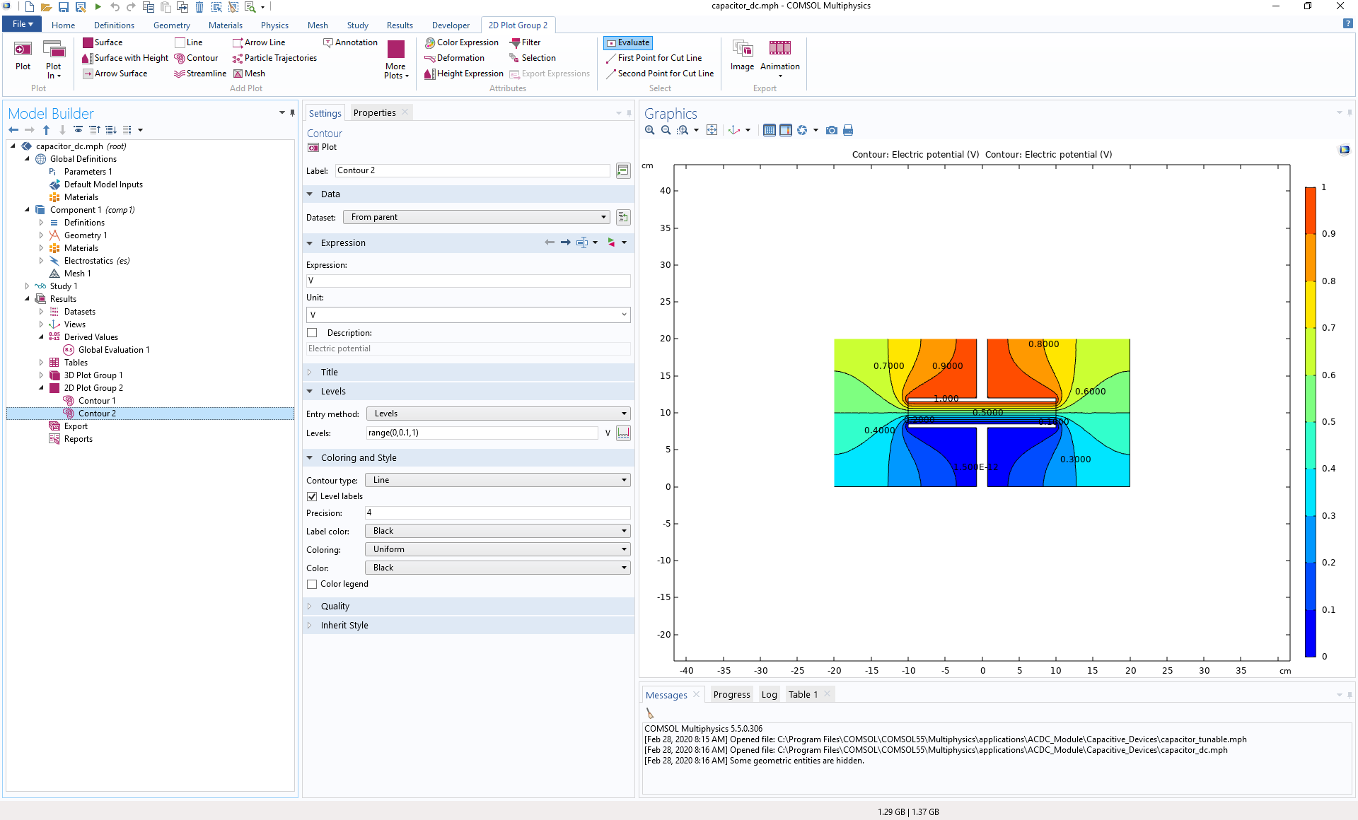

The parallel plate capacitor model that I mentioned above (and which you can also find inside the software under the name capacitor_dc in the Applciaiton Libraries under the File menu) demonstrates how to do that with a contour plot. See also the attached screenshot from that model showing isopotential lines on a cut plane.
Jeff Hiller
The [parallel plate capacitor model](https://www.comsol.com/model/computing-capacitance-12689) that I mentioned above (and which you can also find inside the software under the name capacitor_dc in the Applciaiton Libraries under the File menu) demonstrates how to do that with a contour plot. See also the attached screenshot from that model showing isopotential lines on a cut plane. Best, Jeff
