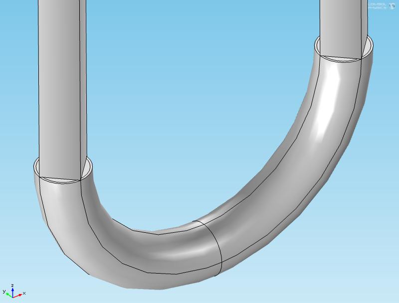

I am trying to create a 3D geometry of a U-bend tube with its thickness. I could not create the legs of the U-tube properly. I got very edgy cylinders (actually they are more like rectangular prisms) and I could not find a way to smooth them (Please see attached file).
First, I created the U-bend by revolving two coaxial circles drawn on X-Y workplane. Next, I duplicated the same workplane and extruded it to create one leg of the U-tube (on the left in the figure attached). For the other leg (on the right), I used COMSOL's built-in cylinder feature, however it was pretty much the same as the other one
When I use Convert to solid for these shapes, I get a very distorted shape. Is there a way to construct this geometry properly?
Note: The diameter of the tube is approximately 2.5 cm and the height of the legs are long (>30m). When I try for smaller lengths (<5m), I get more smooth cylinders. Maybe I should try to create many small cylinder parts and combine them. But I'll appreciate it if anyone could tell me an easier way to achieve this.

check if it's not your graphics screen resolution that plays you a trick (options preferences I believe), or if it has something to do with your geoemtry resolution parameter
but 3cm to 30m is "only" a ratio of 1:10'000
Hi check if it's not your graphics screen resolution that plays you a trick (options preferences I believe), or if it has something to do with your geoemtry resolution parameter but 3cm to 30m is "only" a ratio of 1:10'000 -- Good luck Ivar

youre right, in v4.2 its called options preferenes graphics details and has only a few steps
but with such slender geometry, the meshing settings are also delicate, as this also easily makes prism out of cylinders
in my 4.2a I have no major problems
Hi youre right, in v4.2 its called options preferenes graphics details and has only a few steps but with such slender geometry, the meshing settings are also delicate, as this also easily makes prism out of cylinders in my 4.2a I have no major problems -- Good luck Ivar
