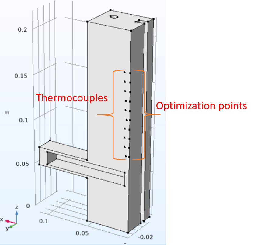

lately I am working on the thermal simulation of a solid material exposed to hot gases to validate some experimental data of around 12000 seconds run time. Inside the solid we measure some local temperatures using 10 thermocouples. Now I am doing a transient simulation, where all know boundaries are defined and based on the thermocouple transient data the heat on the unknown boundary should be calculated. As mentioned I am using 10 thermocouple positions and the data are filtered/smoothed and reduced to 1 measurement/10 seconds, which means one optimization at every 10 simulation seconds. I use the lease-square objective and a local point heat for the control variable, means 10 parameters to optimize. Further I use the Levenberg-Marquardt method. The simulation works so far but it is too slow, even with a course mesh, 4 CPUs and 64 Gb ram available it won't be finished under 24h. With some more refinement even Comsol crashes due to lack of memory. So my question is, is there a way to make things faster? Did I forget to set something else? Since I need to test different meshes and runs several cases and we only have one licence, we can't afford that low speed.

did you try to use linear discretization instead of the default quadratic?

Hi, did you try to use linear discretization instead of the default quadratic? Cheers Edgar

thanks for the idea. I just tried out a case with one parameter optimization. For both configurations, linear and quadratic, the simulation time was almost the same.
