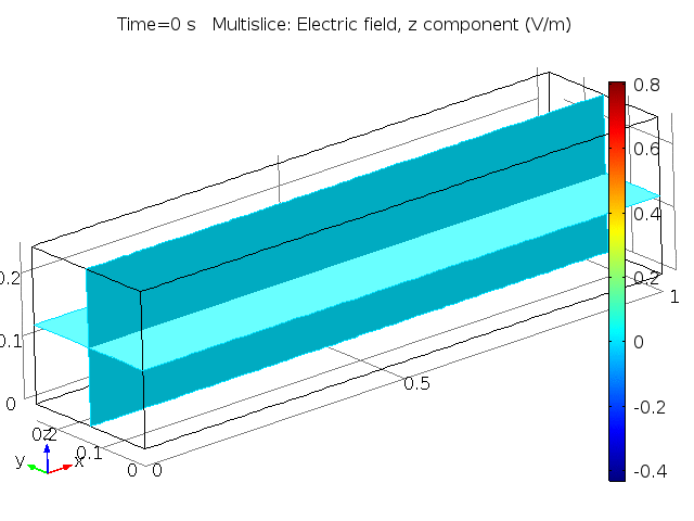

Meanwhile, below is the text from an exported .java file which may help you understand what I did. ( I understand that it may be possible to turn such listings into readable models, but I don't know the details. I saw some info about doing that at: www.comsol.com/community/forums/general/thread/46901 .) Good luck.
* Pulsed_planewave_in_block_without_solution.java

model.physics("temw").feature("sctr1").set("IncidentField", "EField");
model.physics("temw").feature("sctr1").set("E0i", new String[][]{{"0"}, {"0"}, {"mypulse(t)"}});
model.physics("temw").feature("sctr1").label("Scattering BC Wave Launching face");
model.physics("temw").feature("sctr2").label("Scattering BC (wave termination)");

model.study("std1").feature("time").set("tlist", "range(0,1.0e-10,4.5e-9)");
model.sol("sol1").attach("std1");
model.sol("sol1").feature("t1").set("tstepsgenalpha", "strict");
model.sol("sol1").feature("t1").set("timemethod", "genalpha");
model.sol("sol1").feature("t1").set("tlist", "range(0,1.0e-10,4.5e-9)");

model.result("pg1").label("Electric Field");
model.result("pg1").feature("mslc1").label("Multislice 1.1");
model.result("pg1").feature("mslc1").set("expr", "temw.Ez");
model.result("pg1").feature("mslc1").set("descr", "Electric field, z component");
