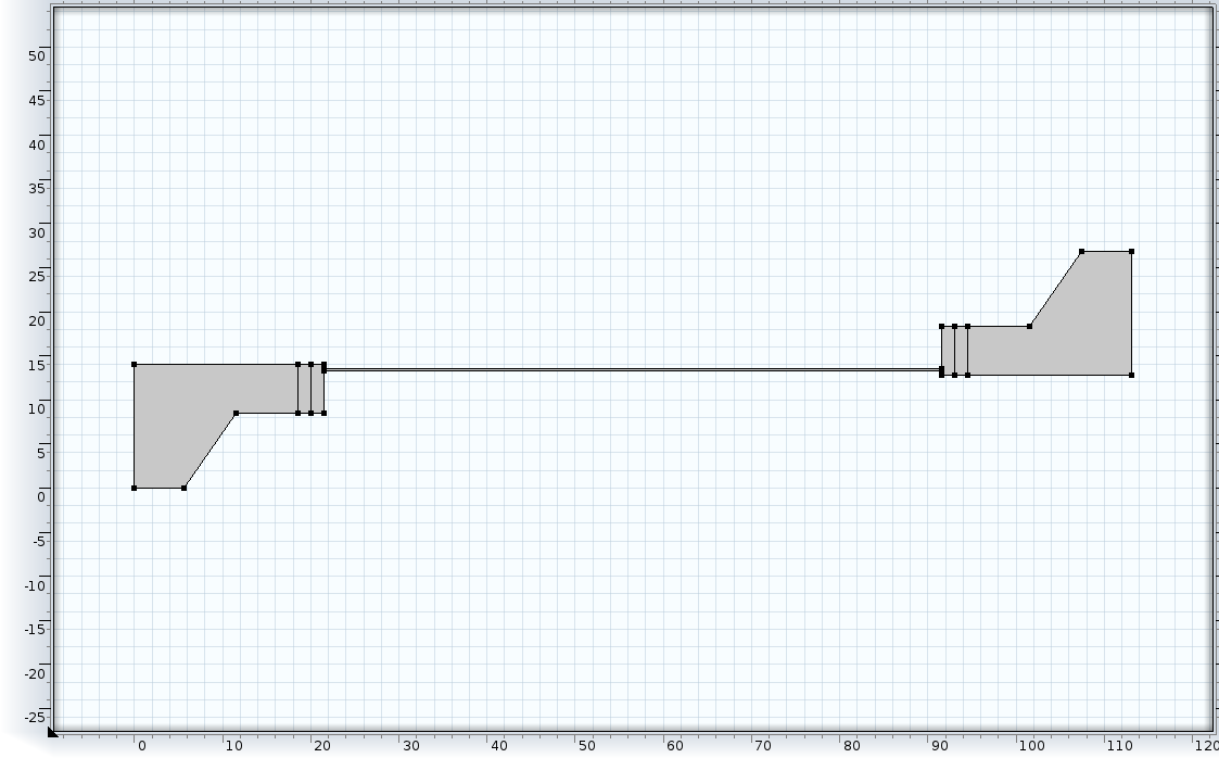

I am trying extrude my 2D model into 3D, but it extrudes entire geometry. I want to extrude some parts of my geometry to 3D, more specifically i want to extrude different parts at different distances. And some of them are even not parallel to workplane. Any suggestions what options can be helpful regarding this??
Thanks
Umar
Hi Ivar, I am trying extrude my 2D model into 3D, but it extrudes entire geometry. I want to extrude some parts of my geometry to 3D, more specifically i want to extrude different parts at different distances. And some of them are even not parallel to workplane. Any suggestions what options can be helpful regarding this?? Thanks Umar

Regarding my previous message, first i have drawn geometry in 2D which is attached with file name geometry-1. Top view of my geometry should look like file name Endblock V2.2_dft_a. I tried using extrude option which looks like 3D cell. I have not experience with 3D structures, please ignore my incompetency on that matter. Any suggestion or help will be highly appreciated.
Thanks
Umar
Hi, Regarding my previous message, first i have drawn geometry in 2D which is attached with file name geometry-1. Top view of my geometry should look like file name Endblock V2.2_dft_a. I tried using extrude option which looks like 3D cell. I have not experience with 3D structures, please ignore my incompetency on that matter. Any suggestion or help will be highly appreciated. Thanks Umar
