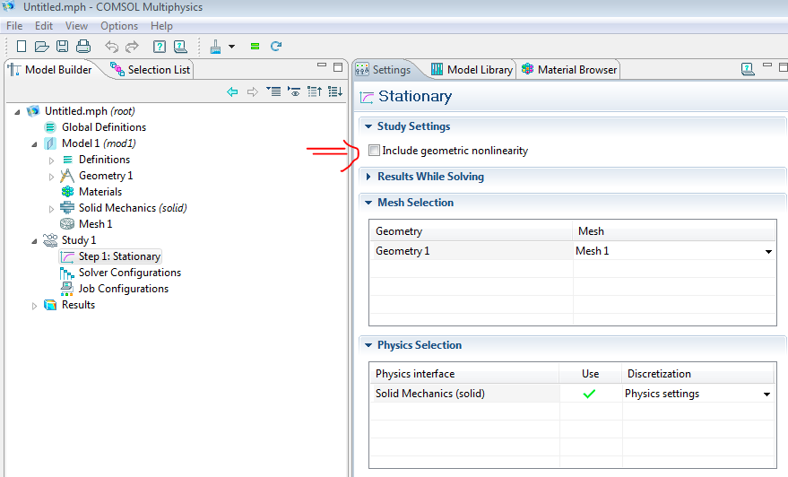

I have an odd problem. I am trying to recreate the Large Deformation Beam model (www.comsol.com/showroom/documentation/model/204/) before I start my own project to investigate buckling. I was following along with the model, but when I go to Study 1 > Step 1: Stationary and open Study Settings, I do not see any buttons that say "Include Geometric Nonlinearity". Indeed, I do not see any buttons at all.
When I download the support file for the Large Deformation Beam model, I do see this button.
However, if I delete the stationary solver and add a new one, I do not see the button any more.

I do (if I select solid, it depends on the physics (also .166 on Win-7)
Hi I do (if I select solid, it depends on the physics (also .166 on Win-7) -- Good luck Ivar

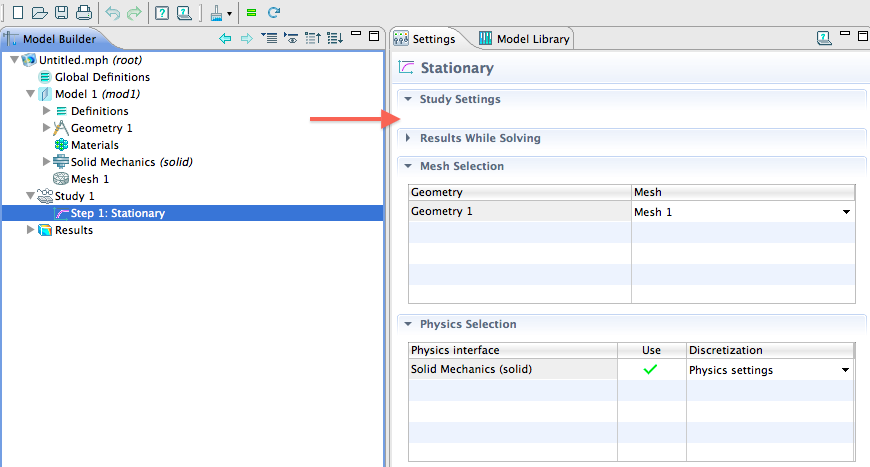

Posted: 1 decade ago 03.02.2012, 17:39 MEZ
I don't (even when I select solid, on a Mac)

Posted: 1 decade ago 03.02.2012, 20:29 MEZ
that's funny, I would say send a mail to "support" and refer to the discussion here, they might have an explanation

Posted: 1 decade ago 03.02.2012, 21:53 MEZ
Are you sure you have the Structural Mechanics module, or one of the other modules that support nonlinear structural analysis?
