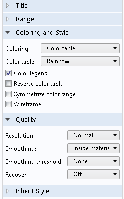

Hi Li,
This all depends on the type of plot you are looking at. Some plots don't have the Quality tab, so this might be the case here. In any case, you are right that the quality tab should generally be under the Coloring and Style tab, as shown in the attached screenshot. If you do not have a quality tab, then this is probably not the issue here...
Cheers,
Alex

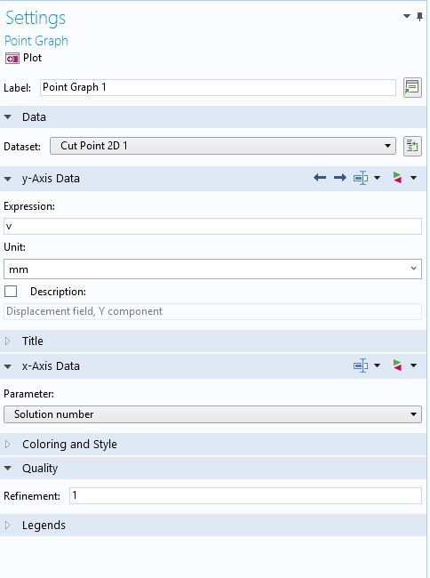

Hi Alex,
I found the quality tab, unfortunately, most of the settings are missing under the quality tab. as shown in the attached figure, do you have any idea why the quality tab in my COMSOL is not complete?
Li

Posted: 6 years ago 07.05.2020, 14:18 GMT-4
Hi Li,
The reason you are not seeing all the options is that you are plotting a Cut Point 2D dataset. The other options spatially smooth the data and its derivatives. Since you are only plotting one point, there is no spatial smoothing to do. The only option is refinement, which means that more points will be evaluated.
Unfortunately, the solution I proposed will therefore not work, since your refinement is set to the lowest amount of 1. I am not sure what else you could try without seeing your model though...
Cheers,
Alex
Hi Li, The reason you are not seeing all the options is that you are plotting a Cut Point 2D dataset. The other options spatially smooth the data and its derivatives. Since you are only plotting one point, there is no spatial smoothing to do. The only option is refinement, which means that more points will be evaluated. Unfortunately, the solution I proposed will therefore not work, since your refinement is set to the lowest amount of 1. I am not sure what else you could try without seeing your model though... Cheers, Alex
