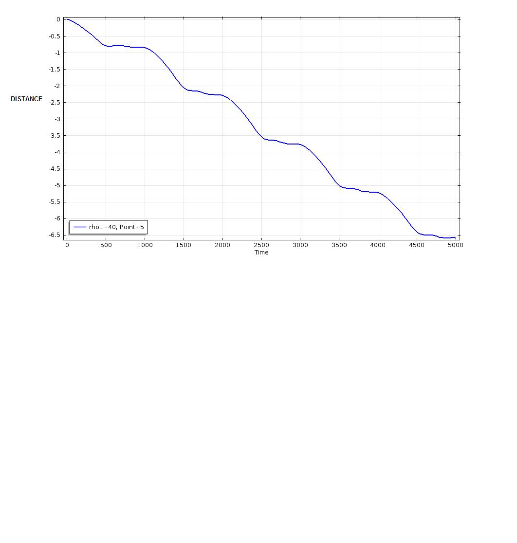

In my 2D simulation I replaced equations with
Qt-Qdot
Qdott-(f_x)/m.
So Q did not affect any existing notations. My problem is as you know flapping like a pendulum. After simulation the graph Q versus time shows distance versus time.
My oscillation was one dimensional but involving to and fro motion.
Please see the attached picture. Actually when the body returns, displacement should be subtracted from distance. I expected a sine wave horizontal to time axis. But I get a sine wave along the diagonal. I suppose that this is distance versus time graph and not displacement versus time graph, which shows accumulated displacement which keeps increasing with respect to time. Am I right?
With lots of regards
Siva
Thank you very much Dr. Ivar. Actually the problem was in axisymmetric. So using X did not affect R and Z ( I suppose). In my 2D simulation I replaced equations with Qt-Qdot Qdott-(f_x)/m. So Q did not affect any existing notations. My problem is as you know flapping like a pendulum. After simulation the graph Q versus time shows distance versus time. My oscillation was one dimensional but involving to and fro motion. Please see the attached picture. Actually when the body returns, displacement should be subtracted from distance. I expected a sine wave horizontal to time axis. But I get a sine wave along the diagonal. I suppose that this is distance versus time graph and not displacement versus time graph, which shows accumulated displacement which keeps increasing with respect to time. Am I right? With lots of regards Siva
