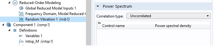

                                                    Hi Theodore,
It is not clear to me wheter the pressure field is distributed, but is fully correlated, or whether there is also a non-trivial cross-correlation with a spatial diestribution.

                                                    Hej  Henrik,
The purpose is to apply a delta correlated excitation over the boundary, i.e. white noise, which is incoherent and by such has no cross correlation.  The model is solved fast and the process is as explained inconsistent to the psd part. My conception was to apply the interpolation, as force per area related to nodes,  as input for the RO model  and use the RO input for the boundary load.

                                                    Hi Theodore,
This is non-trivial, for two reasons.
- For each independent (uncorrelated) input, you need one ROM input.
- Since any boundary condition in COMSOL Multiphysics is applied on a geometric entity, you cannot directly apply loads on nodes.
What can you do then?
As there will have to be a lot of ROM inputs, I do not think this is feasible without automation using a model method or similar.
You can then add a large number of points, each of them equipped with a point load, represented by its own ROM input.
Alternatively, you can subdivide the boundary into a large number of smaller boundaries, each of them with its own boundary load.
In the Random Vibration node, you will have to add as many PSD entries as there are ROM inputs.
How feasible this in terms of computational efficiency, I cannot really tell. That, of course, depend on the number of geometrical objects with corresponding ROM inputs that you use.

                                                    Hej Henrik,
I appreciate the input and yes, more or less I have these processes in mind from Comsol articles and the forum. What you are describing with the multiple ROMs is what I expected from the PSD part as a subroutine. I understand it needs build up from my part.
The process I follow is one described by Mace and Shorter under the overall scope of a mid frequency approach . The main method is characterised of low processing demands. Considering your comment at the end, a question is raised about the process created, since the nodal points are above 1500.  It looks computationally demanding.
