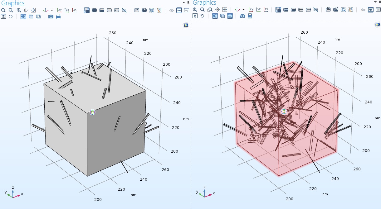

I have programmed a unit area of matrix containing a random distribution of fibres (see attached image). I would now like to effectively measure the volume fraction of fibres within the cube, disregarding the fibre ends that exit the cube faces; this would be so that I could at some point input a dersired volume fraction into my code and generate a resulting model. Is there a way to measure the volume of the cube, for example if i were to use the geometry of the fibres to create voids in the matrix?
Any help is appreciated, thanks!

to measue a domain volume you can set up a domain integration coupling operator, typically it is intop1(). Then you can define a variable, e.g. volume = intop1(1).
Cheers Edgar

Thanks Edgar,
I couldn't find intop1() or anything about a 'domain integration coupling operator' in the COMSOL programming reference manual. Is there somewhere i can read more about this?
Thanks, -alex

This is not about programming. Check in the model builder under Component1 > Definitions > Nonlocal Couplings > Integration

Even easier than that is Volume Integration (of 1) under Derived Values.
By the way- the various uses of the intop operator could be better explained than in the documentation I have been able to find. In particular the significance of the intop operator on a point is...obscure.

I want to add fibres in a programming loop until a defined volume fraction is reached. Therefore, i dont think intop1() is what i need

You can of course use the coupling operations, as well as the post processing integration, as suggested by Dave Greve in application methods.
