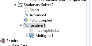

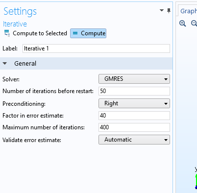

Try changing the preconditioner factor in iteration section of the solver configuration where this warning or error has occured. One can try increasing the error factor as well.
