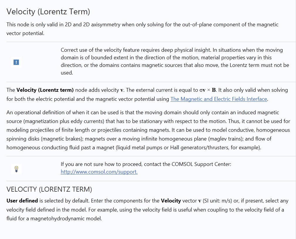

                                                    Yes, but this is the velocity of the medium, not the field.  See the attached, from Comsol's help system:

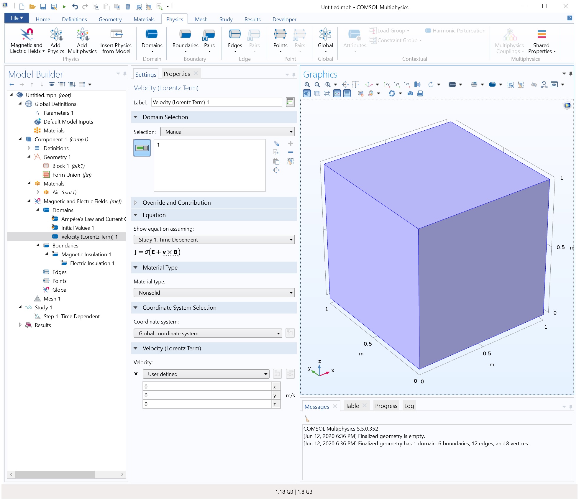

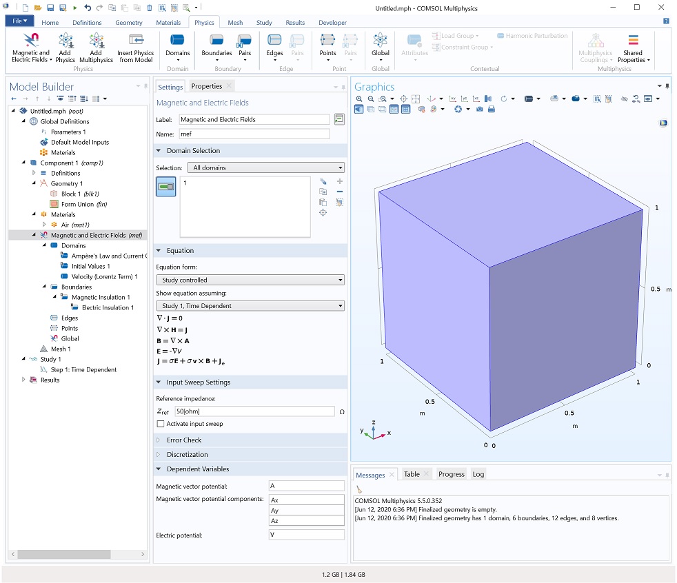

                                                    If you need to work with a material velocity in a 3D EM model, you could use the mef formulation, with a velocity term.  This is available in the AC/DC module.  See the screenshot images attached.
                            If you need to work with a material velocity in a 3D EM model, you could use the **mef** formulation, with a velocity term.  This is available in the AC/DC module.  See the screenshot images attached.
