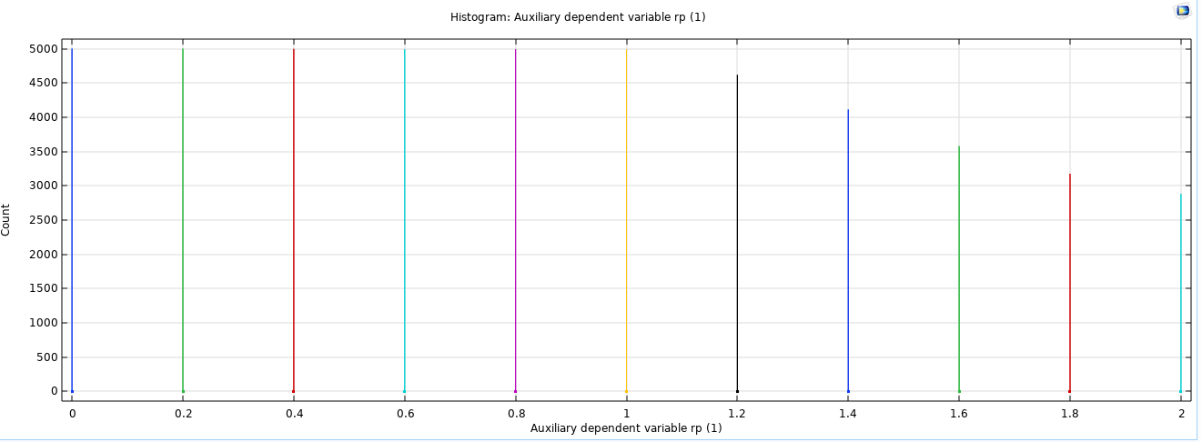

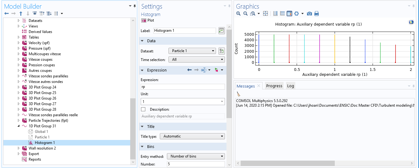

I did stationary study for turbulent flow and then time dependent study for particle tracing. On particle tracing settings, I set up final time as 2 seconds and 5000 particles to release. I defined Wall condition as dissapear at outlet.
This graph seems to show the number of particles still present on my volume at each selected time.
I would like to generate RTD curve, but I cannot decipher how to do it in comsol :/
