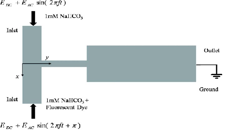

OK. Just think that I'm modeling a single physics and I only want to gain the distribution of electric field within a domain, but some of my boundaries are electric fields instead of potentials. Then, what should I do? What's your suggestion?
Edgar,
That's a good point. I wondered about it myself. However, since I have found this problem in a scientific paper and the authors have mentioned that this is their boundary condition at inlets, I think that it should be sufficient [?]. The fact is that I'm a mechanical engineer and I'm not good enough with all these electric stuff! BTW, I'm attaching an image of the geometry under consideration (taken from that article) for your perusal.
Edgar,

Mohammad,
are you sure the authors are really refering to electrical field strength? Many publications are inaccurate in units and wording. Field strength is a vector, so it must be given in components. And it wouldn't be a single value or vector value in such a complex geometry. It would be a vector field, depending on the spatial coordinates. Is the value given in V/m or in V?
Check the paper for plausibility.

Mohammad,

Edgar,
Thank you for your remarks. You are right. However I have checked the units and they are [V/cm]. Thus, they are electric fields. But your comment motivated me to read again some parts of the paper and I realized that the authors are talking about both voltage and electric fields! In fact, their discussion about electrical BCs seems vague and a bit messy! I'm going to contact them and ask about it. Hope they reply!
I will get back to the topic as soon as I come to a conclusion.

Edgar,
