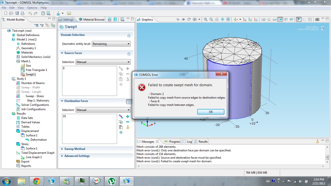

Thanks for your reply but Can you please elaborate your solution further?
I get this error when i try to follow your instructions.
Regards
Sanjay
Thanks for your reply but Can you please elaborate your solution further? I get this error when i try to follow your instructions. Regards Sanjay

are you sure you got all the top surfaces, also the small ones of the beams ?
Hi are you sure you got all the top surfaces, also the small ones of the beams ? -- Good luck Ivar

Yes i guess and also am new to this (was using the Quad for the entire geometry till now) and its not helping either .
