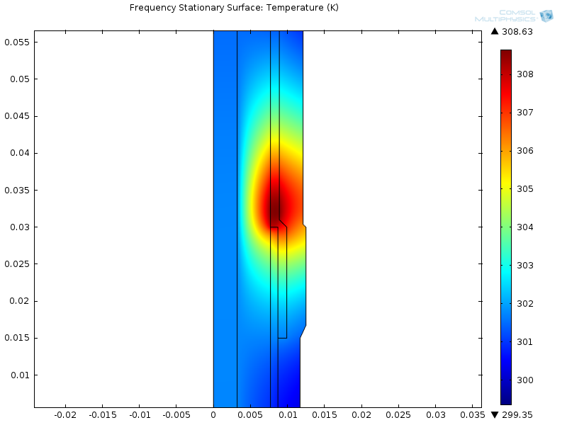

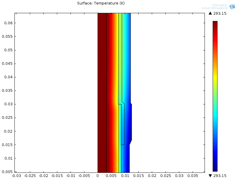

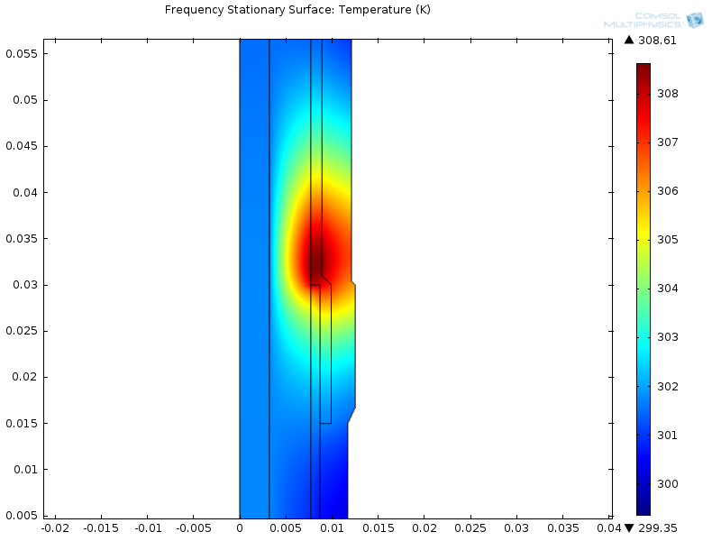

I have joined what I see, file FreqStat is your mesh in freq stationary, then I made the mesh much denser for the regions where the temperature is higest, and added boundry mesh on these 2 domains,"...Dens2", so your mesh isratherrough, ut that is easy to change once it runs ;)
If I use a RMS DV and standard stationary I get the last file, and its almost the same for all mesh density

and the last file highest density frequency- stationary
I was a bit too quick, the finer mesh is not that much different (I had left the 1/sqrt(2))
In the mean time, I have notice that the temperature sems to e essentally dependnet ont he dielectric constatn of your first screen, which gives me the impression you are looking at the capaciative induced losses
