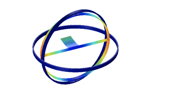

Hi Guys,
This is a flapping and roatating plate used for simulating an insect wing. When this wing rotates as it flaps it creates torsional force. And, I wanted to plot the angle as a function of time of corners at the tip of the plate. The base has a fixed constraint. I just want tips on how to achive this and what data I need from COMSOL.

If you are looking for flapping motion with respect to the rotating frame instead of combined flapping and rotation motion w.r.t fixed/spatial frame, you can use Body defining reference frame functionality in the Multibody Dynamics interface. Here the rotating body can be defined as a reference frame and results can be visualized with respect to this frame.

Wonderful! Thank you very much for the great tip! I will try that!
However, I actually wanted the combined flapping and rotation motion as a function of time (temporal). Any idea on how to do that?
