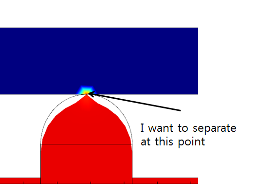

Hello, i am working with transient moving mesh node with two domains.
And i want to simulate,
1. Firstly, two materials were moving same velocity and direction with connected at boundary
2. Then after 1 second, the one material stopped and the other material moved. So, they are separated.
But I found that the mesh at connected boundary of stopped material followed to the moving material.(plz check the attached file)
I think both material were defined as moving with ' prescried mesh velocity'
I want to separate those materials each other.
Anyone can help?
Thanks
1 Reply Last Post 14.03.2012, 07:43 MEZ
Posted: 1 decade ago 14.03.2012, 07:43 MEZ
you are asking for a change in topology that cannot be easily done with a mesh and certainly not in union mode, some phase change methode or clever use of assembly mode should do. Check the doc
Hi you are asking for a change in topology that cannot be easily done with a mesh and certainly not in union mode, some phase change methode or clever use of assembly mode should do. Check the doc -- Good luck Ivar
