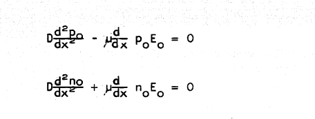

Posted: 10 years ago 12.08.2015, 14:24 MESZ
Hello Ivar
my problem is a little different, but I would be grateful if you could help me.
I am defining my system of equation using Coefficient Form PDE . and as you may find from the attached photo, I have 3 dependent variables: n and p (ion species), E (electric field) which are functions of x (position).
could you please guide me through building these equations?
I am confused with the terms, since for each equation the diffusion term only contains either the variable p or n , but the convection term contains also the variable E.
Regards
Hello Ivar my problem is a little different, but I would be grateful if you could help me. I am defining my system of equation using Coefficient Form PDE . and as you may find from the attached photo, I have 3 dependent variables: n and p (ion species), E (electric field) which are functions of x (position). could you please guide me through building these equations? I am confused with the terms, since for each equation the diffusion term only contains either the variable p or n , but the convection term contains also the variable E. Regards
