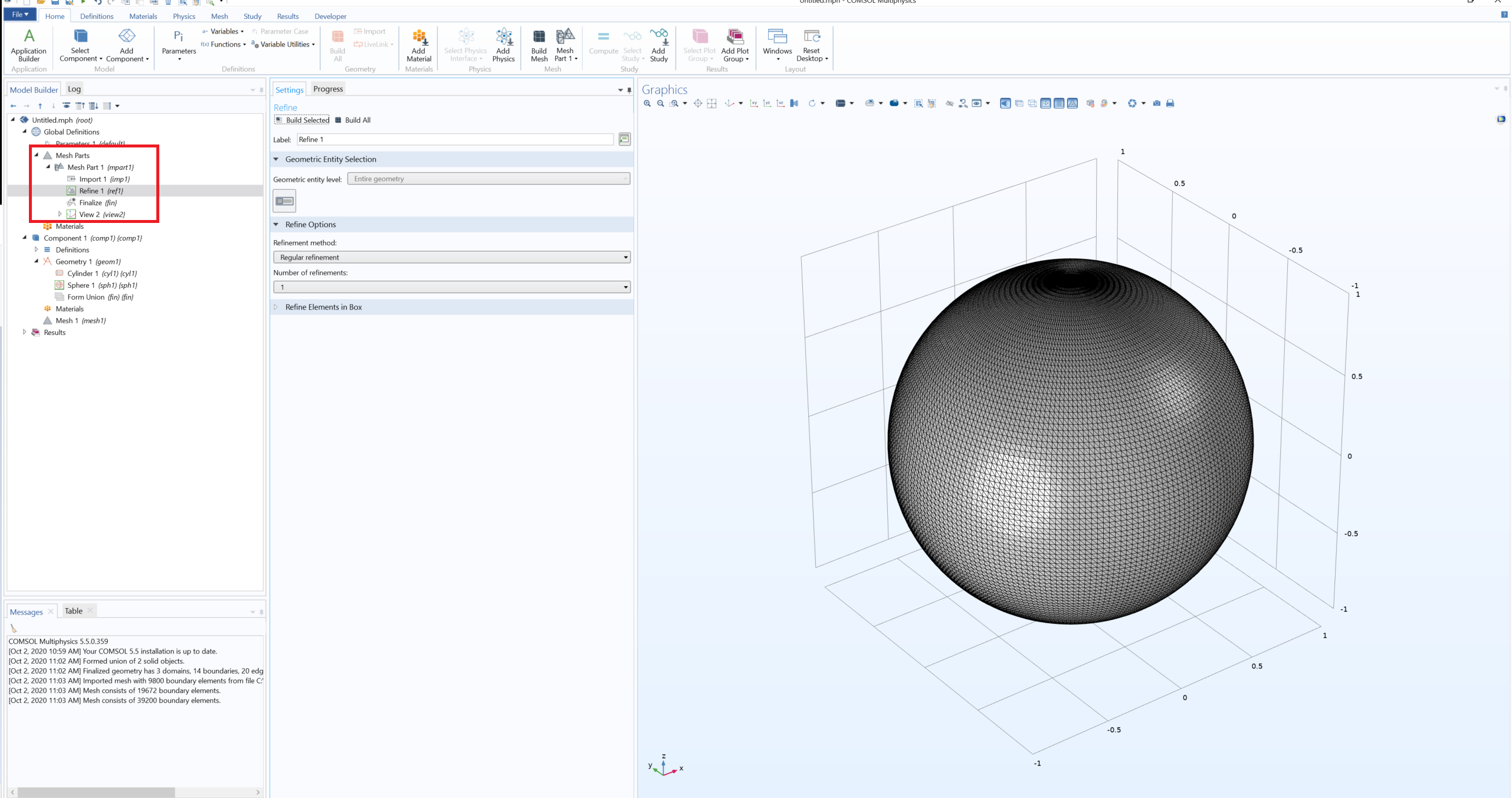

Comsol does not provide any settings for STL export. However, offers a lot of tools for mesh geometries when imported. Therefore an easiest shortcut would be to export your finalized geometry as .STL (binary preferabbly) and then import using mesh part branch under global definitions (as seen in "meshrefinement.png"). There, you will have refinement operations which may help you increase polygon count. Still this may not reflect on exported parts.

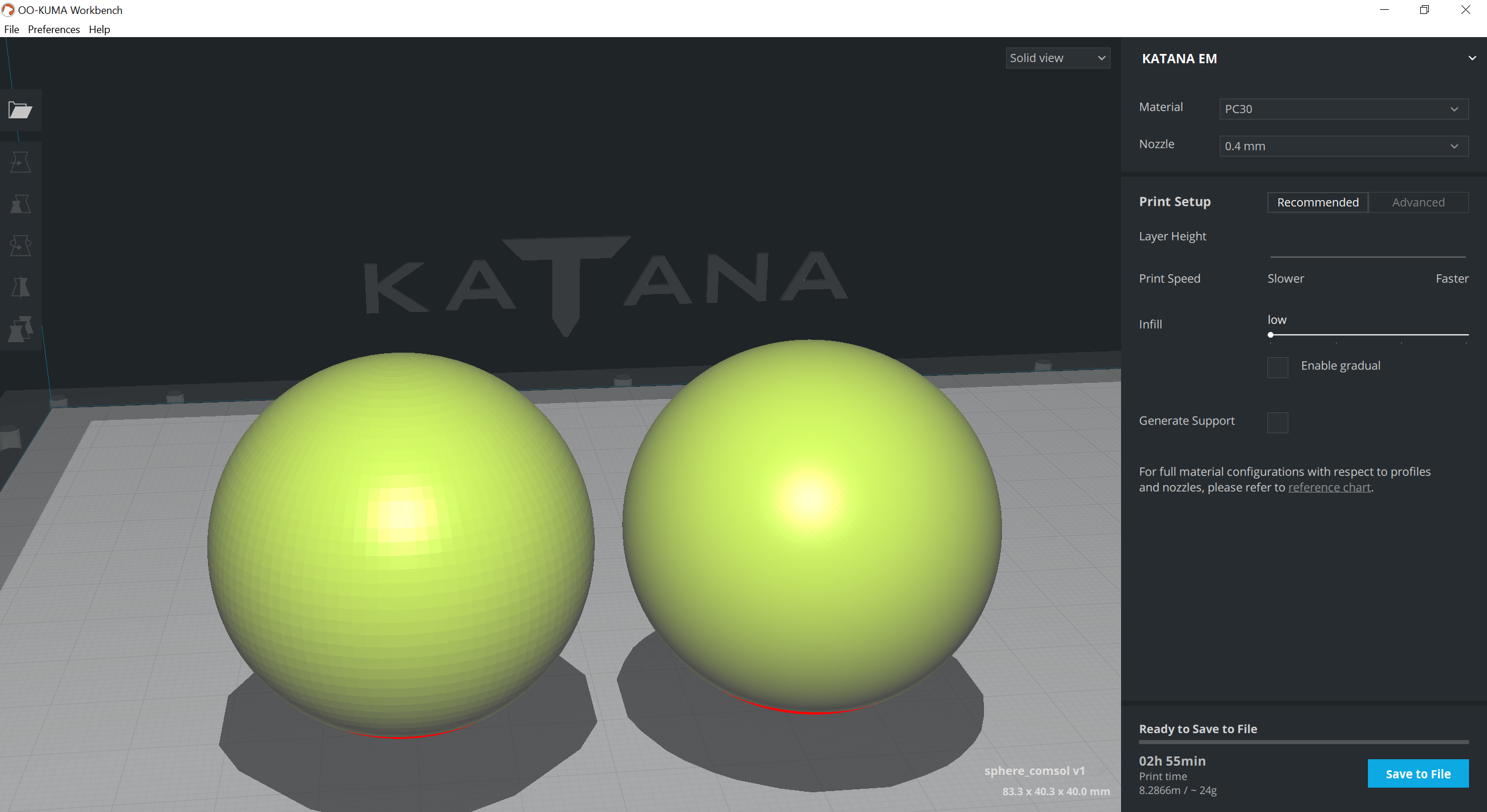

Attached is an example sphere geometry drawn in COMSOL and exported as STL (sphere_comsol.stl). In comparison with its being imported to CAD software and smoothed with respective tools (sphere_comsol_smoothed.stl). Also a screenshot is included for both operations in a slicer of a 3D printer software (meshcomparison.png)
