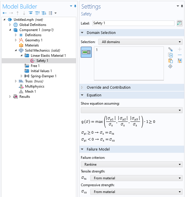

Dear Henrik Sönnerlind, Thank you for your message. I will take a look so on principal stress criterion. In your opinion, can I related the principal stress criterion with the Rankine fracture criterion? Indeed a crack initiates when the maximum principal stress reaches the material strength.
So I was thinking to calculate all principal stresses (x,y, and z) in glass and if one of them exceed material strength, I will consider the damage of the material.
What do you think about it?

The Rankine criterion is built-in; see the attached screenshot.
