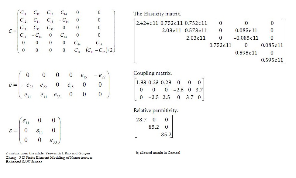

Ok, I will try to simplify my question, by attaching a picture.
How do I go from the elasticity matrix a), which is the one I find in the articles, to matrix b), the one allowed in Comsol?
Or, is there a different way Comsol defines this matrix?

It seems that the difference between (a) and (b) is only due to the order of the stress and strain variables. Variable #3 in (a) is variable #1 in (b), etc. Matrix C is the elasticity matrix which you can input directly in COMSOL using the “Anisotropic” option discussed above.

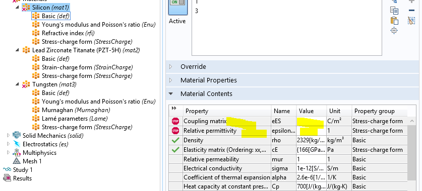

Need to know elasticity and coupling matrix for SiO2
