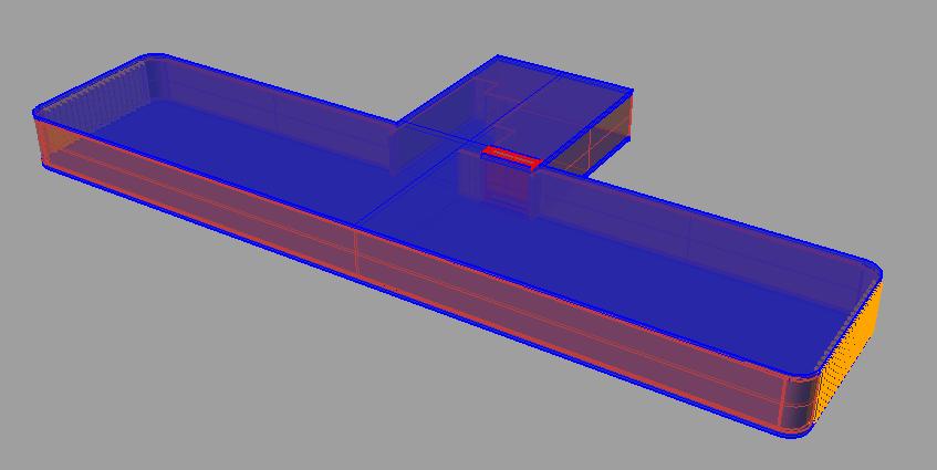

I'm an italian student of the departement of Building Engineering and in this period I'm working on a project about natural ventilation of buildings. In particulary I would like to compare the resuslts of a study that I made in a wind tunnel with the results of Comsol.
In this days I tried to import a 3D model in comsol: it's a model made with Rhynoceros so I save it in the ACIS format in order to import it with comsol, but when I import it I'm not capable to import it correctly and I read the follow message: "error 2152 Unable to determine topology of point in 2D". I tried to import every single different part of the model and it was good, but when I'm going to import the entire model i found the error 2152.
It dipens probabily by the big number of elements? I really don't know..but it's not a very big model, It has been designed in metres and there are not complex geometries. Every part of the model is made by solid elements and not surface.
