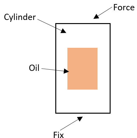

I'm new to comsol and im trying to do get a deflection of a cylinder which has a fluid inside.
The system is as the following:
  1. Cylinder with a cavity
  2. this cavity will be filled with an oil
  3. cylinder will be fixed from the bottom face
  4. a force of 200N is applied on the upper face
  5. hence, the fluid and the system is squeezed
  6. I will get the displacement on the upper surface
  7. I will run the simulation for multiple times but with different viscosities of oil to see the effect on the deflection
I managed to put the force and the fixation and so on. but I failed to add the fluid.
May I know how to accomplish this simulation correctly? I can add the solid mechanics part easily. Geometry is ready as well. My concern is with the fluid part only.
Waiting for your feedback.
Many Thanks.
- A figure is attached for illustration
