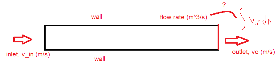

So, if follow what ivar comment, if we want to find volumetric flow rate in 2-D,
we just integrate the velocity [m/s] over the inlet and will get the volumetric flow rate [m^3/s] at that particular inlet, right?

Dear Ivar,
Considering the 2D case, the geometry being a shape of a rectangle.
To calculate the volumetric flow rate at the exit, I do: integrate u * ds? or
u * dx on the border.
Thanks
Well "s" (ds being the elementary entity length, mainly for lines in 2D, is defined from 0 to 1 along any edge in the direction of the entitiy direction arrow (COMSOL decides which direction, you can turn on the arrow representation to check), while x is the true coordinate, so if you integrate ds you get the total length, while integrating dx you get the x component. I believe you can say, in all generality that ds = +/- sqrt(dx^2+dy^2+dz^2)/Length *1[m] as ds has a dimension of length, and the sign is defined by convention
Now in anycase your ds or dx*dy*dz (or only dx depending on the dimensions used) is implicit COMSOL uses it internally for you
The best is to check out such things on simple examples, take a long rectangle, put ina normalised parabolic flow integrate velocity along the input and output and check the coherence of the results, you will soon get the grasp of how to use the integration. One thing, always check your units, as this mostly tells you if you have missed a dimension in your equation, such as the 2D depth that is easily forgotten, or the 2D.axi loop length 2*pi*r ...
