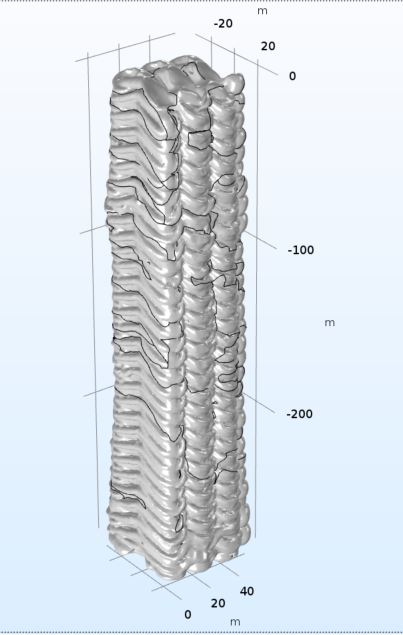

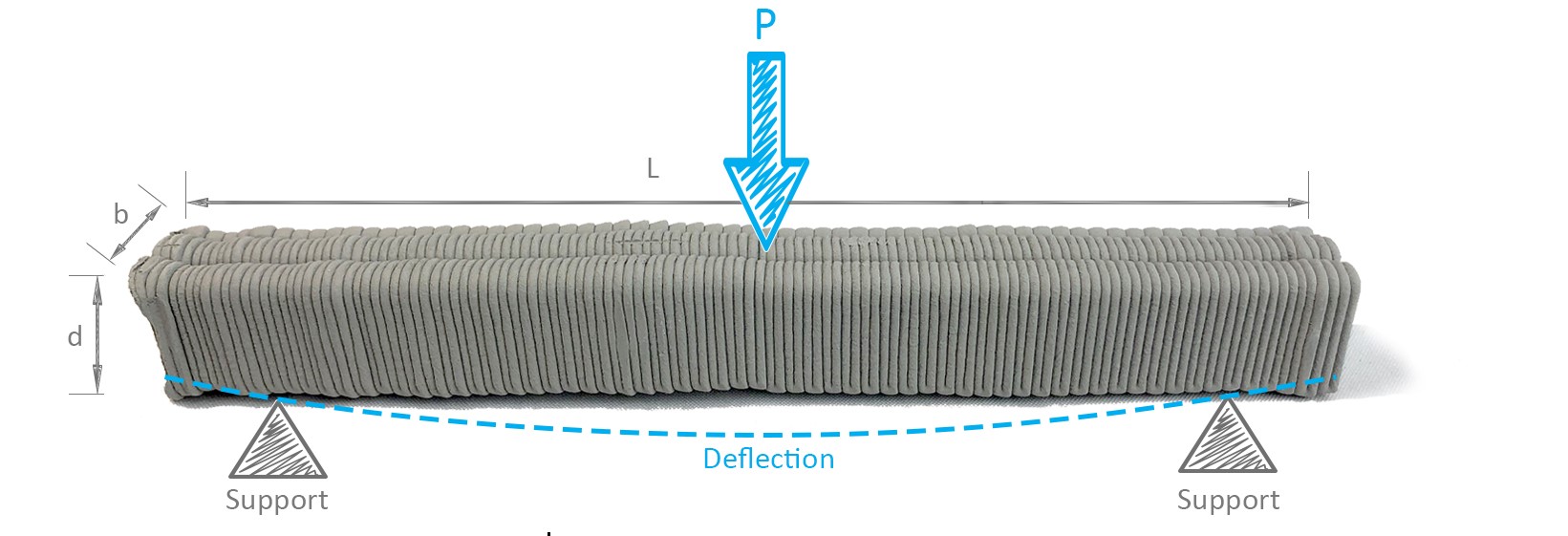

I have scanned a geometry and now want to simulate the 3 or 4 points flexural test on it (See the image)  I am still working on how to import the file correctly into COMSOL (It shows some wired edges on the geometry!). Let's say I can figure that out!
How can I add point loads on an irregular surface while I don't have any vertex/point on that specific spot on the geometry?

Hi Jeff, Thank you for your response. That makes a lot of sense. However, I run into an issue when I try to create the intersection (I use "Partition Objects" as you've shown in your example). Please see the attached images.
Both object and tool object disapear and nothing is left! Do you have any advice on that? Is it related to the geometry I imported into COMSOL?!
Hi Jeff, Thank you for your response. That makes a lot of sense. However, I run into an issue when I try to create the intersection (I use "Partition Objects" as you've shown in your example). Please see the attached images. Both object and tool object disapear and nothing is left! Do you have any advice on that? Is it related to the geometry I imported into COMSOL?! ![ ](https://i.ibb.co/Sn6xw0y/Co1.jpg) ![ ](https://i.ibb.co/K7NS7R4/Co2.jpg) ![](https://i.ibb.co/f9WbmJv/CO3.jpg)
