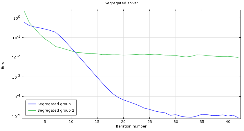

Hi folks,
I have a simulation that is somewhat converging but I wonder about the behavior of the solver...
Please see attached picture for the convergence plot.
The segregated group keeps exhibiting the same behavior. Can anyone offer some advice or insight on this matter?
Is this mesh related?

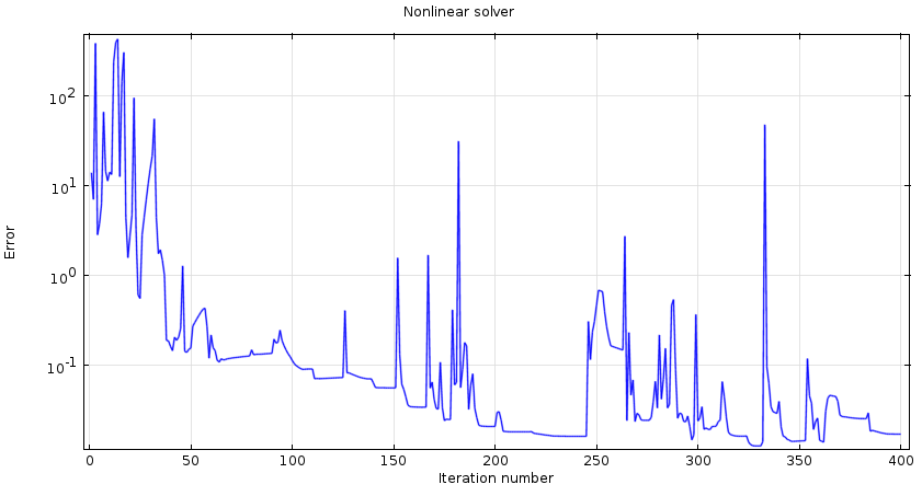

Posted: 1 decade ago 05.07.2012, 19:46 MESZ
Hello Ivar,
I have been working on other issues ans I have returned to question in this post.
Thank you for your suggestions.
However, the problem persists (see attached pic1).
So I used the Fully Coupled + Direct Solver as you suggested (see attached pic2).
Is there a way to somehow give a numerical "nudge" to achieve proper convergence. I have refined the mesh, but
still nothing. I also changed the Damping Factor to a much lower value but I get the same behaviour...
Any thoughts?
Best Regards,
Rui
Hello Ivar, I have been working on other issues ans I have returned to question in this post. Thank you for your suggestions. However, the problem persists (see attached pic1). So I used the Fully Coupled + Direct Solver as you suggested (see attached pic2). Is there a way to somehow give a numerical "nudge" to achieve proper convergence. I have refined the mesh, but still nothing. I also changed the Damping Factor to a much lower value but I get the same behaviour... Any thoughts? Best Regards, Rui
Posted: 1 decade ago 06.07.2012, 08:53 MESZ
well the only I can suggest is that looking at your segregated group convergence, one group is getting "rapidly" stale while the other is slower. This means perhaps that you could solve for part of the variables, and use that asa fixed value and solve only for the other dependent variables, this should make the solving go faster, but you might integrate away too, so its not always the best way, finsihing in a global run with all dependnet variables, using the last solver step is a way to check that you are a t a optimum result point
Hi well the only I can suggest is that looking at your segregated group convergence, one group is getting "rapidly" stale while the other is slower. This means perhaps that you could solve for part of the variables, and use that asa fixed value and solve only for the other dependent variables, this should make the solving go faster, but you might integrate away too, so its not always the best way, finsihing in a global run with all dependnet variables, using the last solver step is a way to check that you are a t a optimum result point -- Good luck Ivar
Posted: 1 decade ago 06.07.2012, 09:07 MESZ
I assume that segregated group 2 is for turbulent parameters (k and eps)? If yes, try changing turbulent length scale from inlet. Good default values is 0.07*inlet diameter. If this doesn't work try to solve problem with very coarse mesh and use this as start value for finer mesh calculation.
Best regards
Tero
Hi, I assume that segregated group 2 is for turbulent parameters (k and eps)? If yes, try changing turbulent length scale from inlet. Good default values is 0.07*inlet diameter. If this doesn't work try to solve problem with very coarse mesh and use this as start value for finer mesh calculation. Best regards Tero
Posted: 1 decade ago 06.07.2012, 17:51 MESZ
The lack of convergence is not always due to solver settings. It may be for example that you are using a stationary solver for a problem that does not have a stationary solution. That happens frequently in natural convection fluid/thermal problems and in solids problems involving contact.
Nagi Elabbasi
Veryst Engineering
The lack of convergence is not always due to solver settings. It may be for example that you are using a stationary solver for a problem that does not have a stationary solution. That happens frequently in natural convection fluid/thermal problems and in solids problems involving contact. Nagi Elabbasi Veryst Engineering
