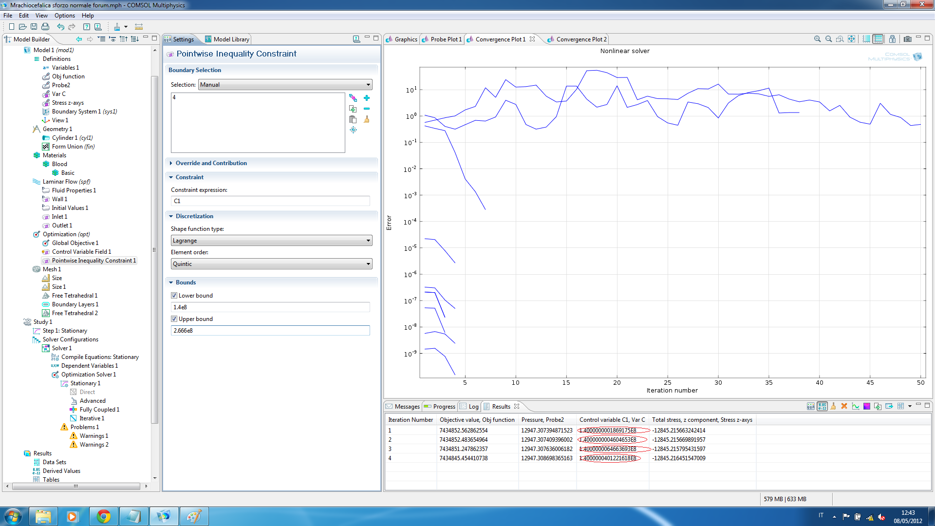

Thank you very much for your answer, i found it very useful. I forgot to specify that my model is 3D and p is the average pressure over the domain (my model is a simple cilinder, so there is only one domain); so i setted up a probe to calculate the average of p over the domain (named by comsol "dom2") and setted optimization module this way:
Global Objective: (dom2-15000)^2
Control variable Field : C with an initial value of 1.4e8 (opplied only to outlet boundary)
Pointwise inequality constraint: C with lower bound=1.4e8 and higher bound=2.666e8
I used that values for C because i found on a paper that they should vary from 1.4e8 to 2.666e8, so the optimal value should be between these.
However i think that i should change some setting to consider the hugeness of C values:
infact, as you can see from the attached image, the variations in C value each iteration is too low, so COMSOL returns only a few of results and then stops saying that the current point can't be improved.

Thank you very much for your answer, i found it very useful. I forgot to specify that my model is 3D and p is the average pressure over the domain (my model is a simple cilinder, so there is only one domain); so i setted up a probe to calculate the average of p over the domain (named by comsol "dom2") and setted optimization module this way: Global Objective: (dom2-15000)^2 Control variable Field : C with an initial value of 1.4e8 (opplied only to outlet boundary) Pointwise inequality constraint: C with lower bound=1.4e8 and higher bound=2.666e8 I used that values for C because i found on a paper that they should vary from 1.4e8 to 2.666e8, so the optimal value should be between these. However i think that i should change some setting to consider the hugeness of C values: infact, as you can see from the attached image, the variations in C value each iteration is too low, so COMSOL returns only a few of results and then stops saying that the current point can't be improved. LOG: Optimization Solver 1 in Solver 1 started at 8-mag-2012 11:59:05. Optimization solver (SNOPT) Itns Major Minor Step nPDE Error Objective 416 0 416 - 1 0.00115 7.435e+006 516 1 100 0.11 2 0.00115 7.435e+006 616 2 100 0.07 4 0.00115 7.435e+006 716 3 100 1.00 5 0.00115 7.435e+006 Warning: There were 8 warning messages from the linear solver. Warning: Ill-conditioned preconditioner. Increase factor in error estimate. Warning: Forward solution failed, requesting reduced step. Warning: There were 61 warning messages from the linear solver. Warning: Ill-conditioned preconditioner. Increase factor in error estimate. then i canceled the process. Should i increase the C value increase at each iterations?

The ill-conditioned preconditioner warning suggests that your model is not well formulated. As Ivar suggested, try running a parametric sweep on several values of C across your inequality range to make sure the model solves properly. This will need to be fixed first.
Other comments:
I see you have variables C1 as well as C. What is the purpose of C1? You should optimize C directly if C is the parameter in your equation. This may contribute to the lack of progression in your optimization.
I see you have defined a Control Variable Field for C. This should be a Global Control Variable defined as C.
You have defined a pointwise inequality constraint on C1. This perhaps should be a global inequality constraint (again, on C rather than C1). With C defined as a Global Control Variable however, you can provide the upper and lower bounds in that dialog box, eliminating the need for this additional constraint.
Your model is stuck with a pressure of 12947, which is a distance away from your target of 15000. Using the parametric solver, make sure there is not a local minimum near that value of C. Given the form of your equation, I suspect this is not the problem, and reformulation of your model as described above may take care of this.
