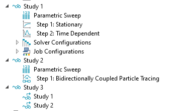

I am trying to run 2 studies in a comsol batch. In the COMSOL GUI I make a study 3 which is combining study 1 and study 2.
Study 1 : Stationary and time dependent substudies (stationary is input for TD) Study 2: Bidirectionally coupled study
Within these 2 studies I also try to do a parametric sweep (see attached image for study tree).
Study 1 seems to have no issues at all and solves sucessfully. However, study 2 encounters an error and is completely empty at the end. The error is as follows:
/******************/ /*****Error********/ /******************/ Error in sweep. - Parameters: "I_beam","2E-8" Invalid property value. - Property: looplevelinput (Loop level input) 'Loop level input' is an array of strings. "all", "first", "last", "manual", "manualindices", "interp" Saving model: E:\current\ACC_psweep_current_SC_output.mph Save time: 140 s. Total time: 844 s.
I am not sure what this means, I have checked all parametric properties and study properties but they are almost exactly the same as study 1 so I am not sure why I does not solve sucessfully.
The batch command I use is : comsolbatch -study std3 -inputfile input.mph -outputfile output.mph
