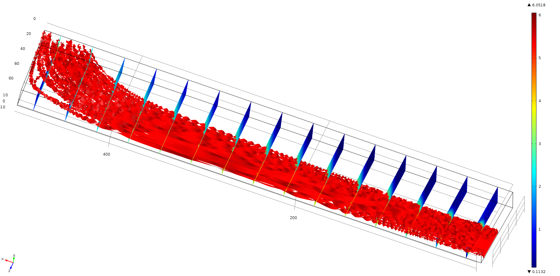

I also strongly recommend to use direct solvers, possibily PARDISO, when doing CFD. Please find attached a sample about how you can solve your problem and a picture of velocity+streamlines.

Nevertheless, when I utilize your model, whatever pressure I set at outlet, the flow profile doesn't change (it seems to only bias the whole solution).
Another problem I found is that in this model : there is always a "backflow" into the chamber next to the inlet, while measurements show no such a behaviour. I have an outlet flow velocity profile measured:
