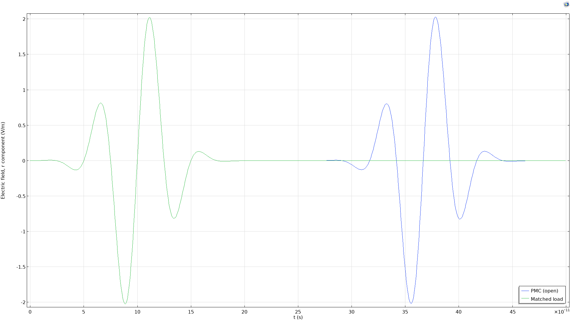

I'm using the coaxial_cable_transient verification example from the RF module. I noticed that by default the calclulated fields have an immense amplitude of 1E13 V/m (I guess by default this gives the 50ps gaussian pulse a unit area). That seemed awkward, and I prefer to have field amplitude normalized to 1(V/m) so I multiplied the input pulse by a 1E-13 scalar to give it a unit amplitude. That's all I did. I put a 1E-13* in front of the V0(t) in the Voltage parameter for Lumped Port 1 to try to get things nearer to 1 V/m.
Much to my surprise, this seems to totally break the simulation. The wave pulse gets about halfway into the coax and then disintegrates. The solver terminates very quickly. No error or warning is given, but the simulation is clearly wrong. I tried other scale factors. Everything seems to work down to 1E-8, but starts to go to hell at around 1E-9.
Is there some underflow bug in Comsol? Or is this some well known scaling limitation? I'm running Comsol 5.1. Please don't lecture me about upgrading. Why would a simple scale factor on the fields break things in any version? I just want to know if this bug is really there, or if I'm dumb for thinking I can normalize the input pulse to 1 V/m in this verification example. Maybe I need to click on some arcane solver option to get past this? Thanks if you can help.

Interesting. This appears (to me) to be a solver-related step decision-making algorithm issue. I'm running v. 5.6, but yes, I can see similar behavior. For what it is worth, I also see that if I go to "Study Settings" under the Settings panel, and reduce the "Relative tolerance" from .0001 to 1e-6, the computation then becomes stable and runs successfully to the end, but the result appears less accurate than in the original run (errors are appearing). Reducing the Relative tolerance to 1e-7 works better, but takes much longer to run -- so that's a clue as to what is going on, I think! If, under "Time-Dependent Solver 1," you look at Time Stepping, the method there is Generalized alpha, and steps taken by solver = free. This is sometimes a recipe for disaster in time-domain computations, because the code has to figure out for itself what time step to take. You might want to consider changing those settings to something stricter. Anyway, try the above ideas and see if (or how well) it works for you. Meanwhile, perhaps another user who knows more about the details, or one of the Comsol staff, would like to comment? Good luck.

For fun, I tried a simple step driving the coax, rather than a pulse, and even with a step I need to make the amplitude a trillion volts for the model to work right. If I use a 1 volt step the results are garbage in the sub-nanosecond timescale.
I think maybe the temw solver isn't able to work correctly for this timescale.
For fun, I tried a simple step driving the coax, rather than a pulse, and even with a step I need to make the amplitude a trillion volts for the model to work right. If I use a 1 volt step the results are garbage in the sub-nanosecond timescale. I think maybe the temw solver isn't able to work correctly for this timescale.
Posted: 5 years ago 02.04.2021, 17:34 GMT-4
I can get a coax to simulate correctly with a 1 volt input if I control the time step manually, cranking it down manually to a picosecond. So it's definitely a time-step estimation bug. If I had to guess what the bug is, I'd guess that the time step estimator doesn't adequately consider the timescale being specified in the study setting and the "adaptive" aspect of the step size algorithm isn't quick enough to recover from such an initially bad guess (10 orders of magnitude off) unless "incentivized" by a ten-trillion volt amplitude.

The model is using a pulse that gives a maximum Magnetic vector potential (A) of the order 1e2. This A field is the only dependent variable, and what matters for the numerical method. The E field and other postprocessing variables are not relevant for scaling or for termination of the solver methods.
The automatic scaling is not being able to pick up the correct A-scale since it is not considering any transient (boundary) data or behavior. It is based on initial values, zero here, which leads to a fall back to “1”, which works fine here for the port-pulse size in the model. When the pulse is scaled, naturally the “A” field is changed. But the automatic scaling does not pick this up, it is still “1”, and very off. By correcting this by using Manual scaling A ~ 1e2 * 1E-13 = 1E-11, things are just fine. The model can then be improved further by using a manual time-step of 5e-13 and the model solves in 9 s on a standard machine, with good accuracy. Attached is a screenshot from COMSOL version 5.6 with the “normalized” E field. Both open and matched BC are shown. Observe that with manual time-step the model is not as sensitive to the correct scaling since the time-step is not selected based on error estimates anymore (which requires correct scales). But in general also for this case proper scaling is needed, since else the algebraic problem (solved in each time-step) can be off.

Thank you @Jeff for explaining that the A field is what matters for the numerics. This will allow me to proceed with some confidence that I know what the problem is, and how to avoid it.
I do still wonder what priorities for temw led to having 1 volt on a coax as "scaled", requiring manual considerations; and a billion volts to be where things work naturally. It is, after all, the "transient" emw physics. Are there real-world problems where the default makes sense? I'm sure you know that a billion volts on a coax is not phyically reasonable. At least, a discussion of this scaling issue should have been part of the documentation for this "validation" example.
