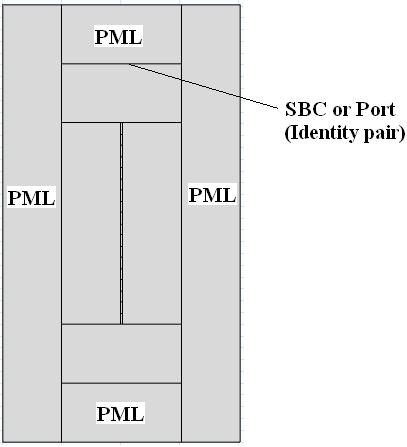

I have simulated a model, please see attached.
If I do “form the union”, the inner boundary can not be used to set as SBC or Port.
So I do "form a assembly", and define a idensity pair. Now I can set the inner boundary as light source.
However, an error occurs as:
Automatic scaled regions cannot treat selections without exterior and interior boundaries.
PML geometric setting types is Cartesian, I change PML geometric setting types as General,
The calculation can process, but the results are confusing.
Expecting you to give me some help!
