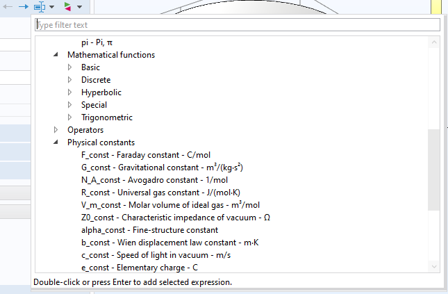

Yes, from the File menu, choose Help>Documentation (or press Ctrl+F1) to get access to the entire COMSOL documenation set. Search for physical constants, for example, to find the information you need.
During postprocessing, in text fields for expressions, press Ctrl+space to open a window where you can choose from all relevant constants, functions, and variables and insert them in the expression to plot or evaluate (see the attached screenshot).

Yes, from the **File** menu, choose **Help>Documentation** (or press Ctrl+F1) to get access to the entire COMSOL documenation set. Search for `physical constants`, for example, to find the information you need.

                                                    Hi Magnus,
Awesome! your help is much appreciated.
This is what I was looking for.
The attachment also helped. I use that to find the equations.
The ctrl+space takes me to the unit system window. (I am on windows)
