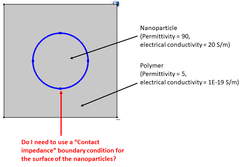

I am trying to build a model of nanoparticles in a polymer. The object is to evaluate the Terminal current and surface current density accross the polymer. One example from the blog, "MAxwell-wagner-Permittivity of Blood" was really helpful. However, unlike their model, my model does not have an intermediate layer between the nanoparticle and the matrix. The model is as below image.
[Image]
My questions are as follows -- 1. Do I need to put a contact impedence BC for the surface of the nanoparticles? 2. If yes, what "Surface thickness (Thin layer)" or "Surface impedance" properties should I use? Note: I am only putting nanoparticles (Such as - TiO2) in polymer (such as - PMMA).
The terminal current is almost the same if I use or do not use the Contact impedence condition, but the surface current density is completey different!

Didar,
if you aren't considering a contact layer in your model, you probably don't need it. The electrical contact between the domains is established automatically in a Form Union. It is to be expected to change the results if you use it nevertheless.
Cheers Edgar

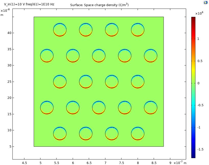

I had another question, related to this. If I extract the "Surface Charge Density" from the results, the unit I see is C/m^3. I do not quite uniderstand, though I have 2D model, how can the unit be m^3?

The root physics node in 2D has a setting for model length in the 3rd dimension. The volumetric charge density takes this into account.
Cheers Edgar
