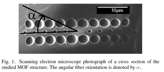

Thanks to both Ivar and Felipe,
I am doing simulation of the NEMO fiber( I have attached the SEM image from Geernert et.al. IEEE photonics letters,20, 8, 2008) with dooped core( defect in the centre).
I have put a rectangular PML around the airholes so as to enclose the microstructure,
If I give assign the PML refractive index the cladding refractive index I do not get fundamental mode at the expected mode index but if I do the same with air refractive index I get the results.
I do not know exactly as to why the air refractive index for PML works even though its inside the cladding. Can someone clear my doubt?
Akhilesh
Thanks to both Ivar and Felipe, I am doing simulation of the NEMO fiber( I have attached the SEM image from Geernert et.al. IEEE photonics letters,20, 8, 2008) with dooped core( defect in the centre). I have put a rectangular PML around the airholes so as to enclose the microstructure, If I give assign the PML refractive index the cladding refractive index I do not get fundamental mode at the expected mode index but if I do the same with air refractive index I get the results. I do not know exactly as to why the air refractive index for PML works even though its inside the cladding. Can someone clear my doubt? Akhilesh
