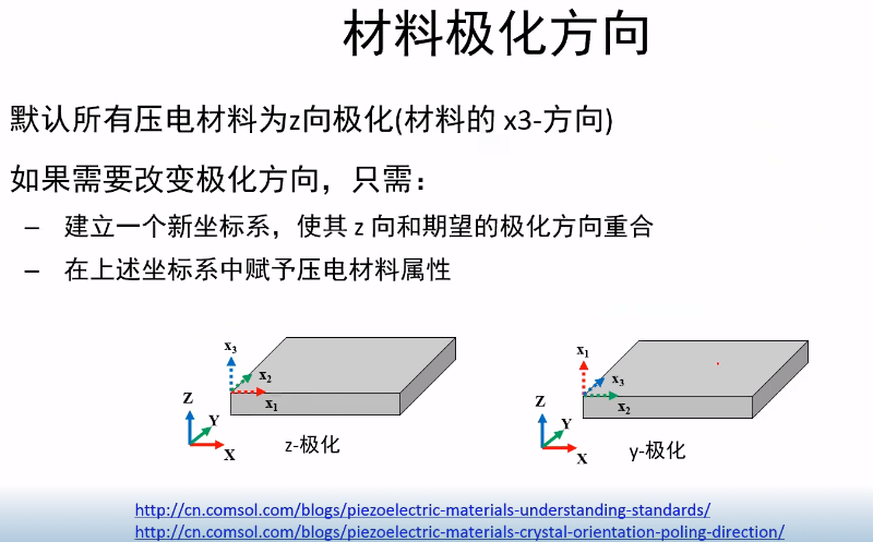

There are two links mentioned in the video, but the picture in the link is different from that in the video. What should I pay attention to?
